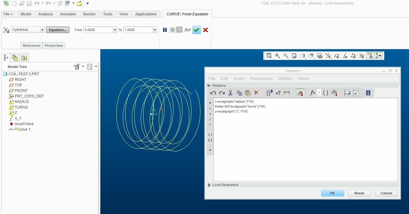

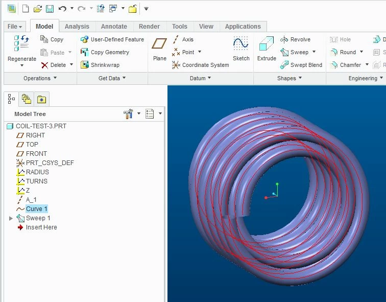

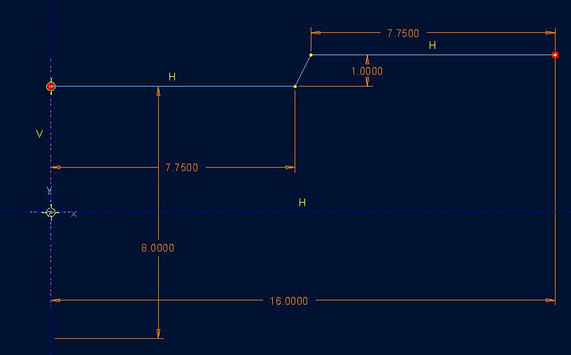

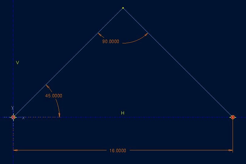

I've been following some of the section sweep experts on this forum and I've been able to reproduce the following so far.
This is a two layer winding using a curve generated by cylindrical equations as the base for the sweep profile.  The equations are:
r=evalgraph("radius",t*16)
theta=360*evalgraph("turns",t*16)
z=evalgraph("z", t*16)

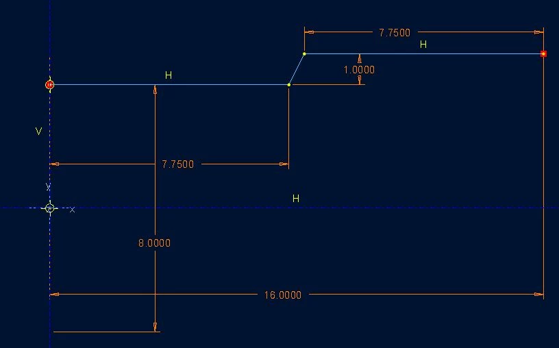

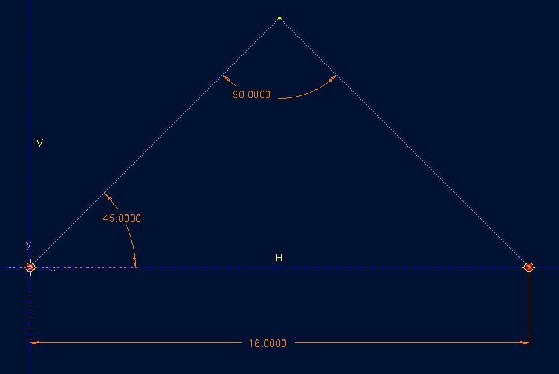

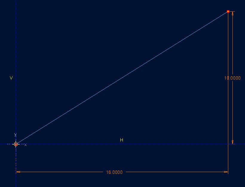

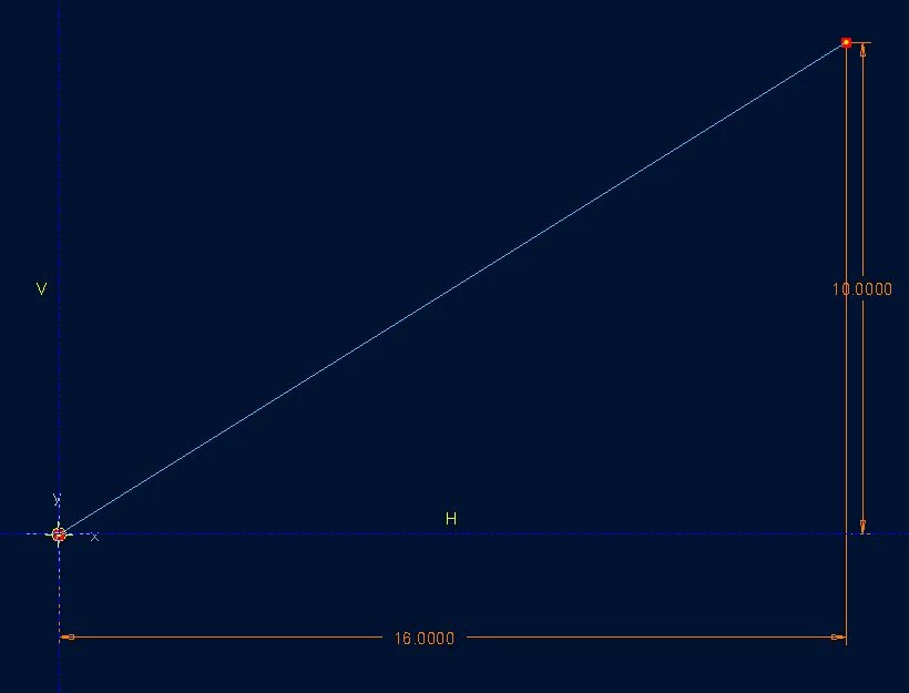

Graphs:
All of the above is taken directly from this post One method to make wound springs I only reproduced what had been done and put the coil reversal condition in it.
How do I take the next step and go from a winding with a round core to one with an irregular shape?  I'd like to wrap two layers of a coil around a pill shaped mandrel.

Just change your radius graph.
mryan-21-VisitorAuthor
September 7, 2016
Thank you for responding but I'm stuck as to what the graph should look like.  Can you offer any more information?
September 7, 2016
The graph will look a lot like your mandrel profile.  Remember this is a radial setting.
The graph horizontal represents duration (0 to 1 as trajpar is also 0 to 1) and the vertical represents your actual radius.
So if the graph looks like your mandrel with an offset accounting for the wire thickness.
p.s.... the example uses 16 as a horizontal measure.  Note that trajpar is also multiplied by 16 in the sweep relations.
Some of this just takes getting use to.
If you use trajpar inside a sin or cos function, then you have to remember to multiply trajpar by 360 (degrees) so you get the full sweep of the wave.
