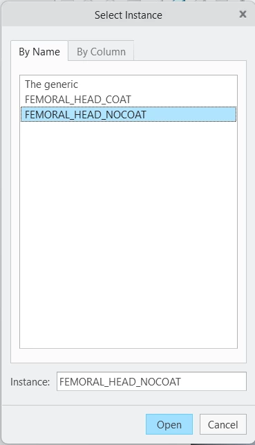

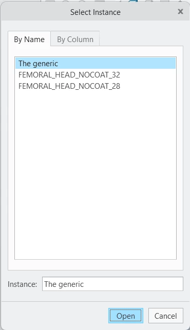

Hi everyone, I am using Creo 9.0, and when trying to open one of the variations of my project created through nested families, the parameter I want to change gets changed but there is no way to regen the model. When I go through the first set of families it works perfectly, then I can choose the generic and everything works fine, but it doesn't work as it should.
I attach some photos.

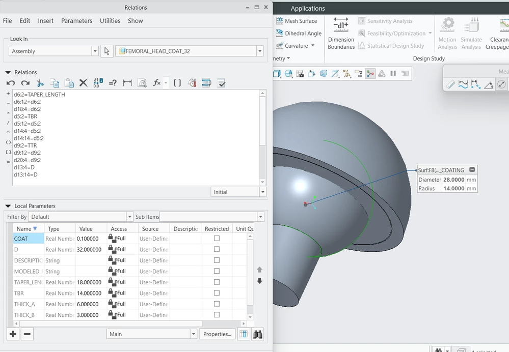

You're using Session IDs in your relations. Every instance in memory will have a unique Session ID. If you have used d6:2, but the instance now in use is different, i.e. it now has Session ID 28, your relations will not work as expected.
When I need to do something of this nature, if I do in fact understand your intent, I ensure the component models have all the different iterations needed, then call those in the assembly family table.

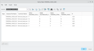

I don't see how that would be my issue, since my relations are working perfectly fine, except when I try to change the parameters from the family table it just doesn't work. If I get to just the coat or no coat versions, and then I select the generic version of those, it lets me change the parameter and regen it properly, but not if I do it from the family table. I've tried to put it all in the same family table, as I understood I should do from both comments I've received, and still it doesn't work. I did it with nested families in that way since is the way I've learned at university.

Are you trying to load two instances from your top level "HEAD..." at the same time? If so, how do you know what the dimensions of the component parts should be? What will happen, if I'm thinking through things, is the "last" assembly to have its relations evaluated will "win". It is the one whose dictated dimensional values will be applied to the components.
There is not a different component loaded for every assembly you have in memory. If you have a part that is being used in all the assemblies, it is a part in memory only once. It has its own Session ID. If you load up another assembly that uses that same part, it references the exact same part that is already in memory. So if that second assembly makes changes to the part those changes will take effect and thus change what is going on in the first assembly. This is why I generally don't use assembly relations to drive dimensions in components.
My method for doing what you seem to be trying to do would be to:
(1) Build the lower level part(s) with all the options I think I'm going to need. For example, "femhead" will have a family table with instances like "femhead-32dia-coat", "femhead-32dia-nocoat", "femhead-28dia-coat", etc.
(2) In the top level assembly, say "femhead-asms", just have the generic, "femhead" in the assembly with the other parts.
(3) Put a column in the family table of "femhead-asm" for the "femhead" component.
(4) For each instance of the assembly, instead of the default "Y" or "N", put the name of the version of the "femhead" part that you want for that instance. For example, "femhead-asm-32coat" would have "femhead-32dia-coat" instead of "Y" in the "femhead" column.
Perhaps this method of structuring the assemblies will work for you.
