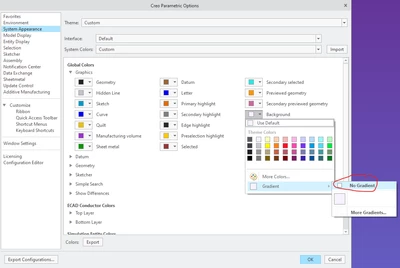

I just ran into this issue when a user was attempting to save a JPEG. We were able to narrow it down to the system colors file. Try launching without a system colors file and see if that fixes the issue. I think the issue is related to gradient backgrounds.
@Tdaugherty Moonstone: what do you mean by " launching without a system colors file"?
Most likely, you are pointing to a system colors file in your config file. You can comment out that line or add a new path in your own config to a new file. Kinda depends on how you have your environment set up. Alternatively, switch to one of the default backgrounds in the options menu before exporting your file.
kdirth
I does appear to be a gradient.  In Options, select No Gradient.
Thank you for your replies. Unfortunately it seems that it is not the issue. I do have "checked" no gradient box and it still appears as in my pdf.
Is there a possibility that it "bites" with some other command?
Based on my testing, I don't think unchecking that box solves the issue. You need to actually launch with a clean system colors file.

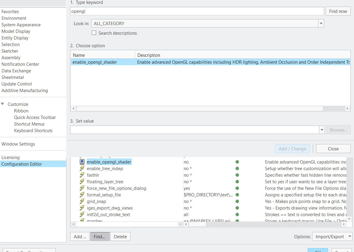

Robert,
Try setting the following config.pro options and try again.
enable_opengl_fbo no
enable_opengl_vbo no
enable_opengl_shader no
D. Nordin
Hi D. Nordin,
I could find in the configuration only "enable_opengl_shader". See attachment.
Unfortunately changing to "no" didnt help.
Br,
Robert
Robert,
The other options are hidden options. You can simply type them in. You will need to save the config.pro file as these options require you to restart Creo Parametric.
Dan
