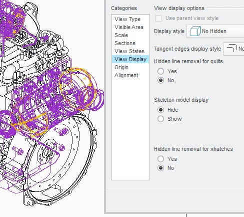

Dear Experts,
I have created a customized creo drawing template, with views, tables & annotaions. I am able to pull this drawing template using VB-API everything is coming perfect.
But the problem what i am facing is the assembly contains lot of imported features unwanted surfaces and all. While creating the template i could not find any option to hide the "Hidden line removal for quilts"  &  "Hidden line removal for Hatches"
Please see the image below.
As you can see like this i have almost 20 to 30 views in my template. What i am doing now is i have created a MapKey to execute this step. Still it takes lot of time to excute the whole template.
So my question is, Is there any way i can control this 2 options either through template or by VB-API, So that i can save execution time.
Any Suggestions will be very much helpfull.
