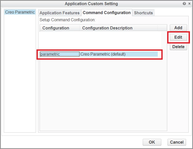

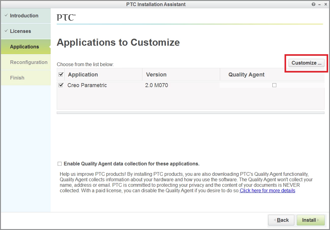

There seems to be an issue with the Assembly license, and I cannot "Include" components in the assembly that I'm working in.
Does anyone know how to go in and update the license setup? I have all licenses, but the guy who usually configures these things is on vacation.

Don,
if you want to change a license attached to your launch command, run reconfigure.exe
from Creo2\Parametric\bin directory and click Configure button. See attached pictures.
Martin Hanak

Thanks! That was a big help... all set now!
