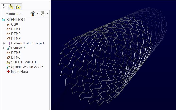

Best answer by TomD.inPDX
I took the liberty of creating something like what you are trying to do. This is the in the same vane... patterned shape joined at opposite seam w/ control over the cylinder's radius which is variable in relations (defaults to the measurement between the two outside planes; original length). Limitations of the spinal bend forces you to work with a feature that entirely between the two outside edges or it will truncate the remaining feature. This is the reason for the extrude cut included to mate/match the seam.
The attached file is Creo 2.0 full version.

March 22, 2013

May 8, 2013
A follow-on to the original question.. I've got the general geometry, but there is a seam where the two ends of the flat sheet meet from the Spinal Bend. I believe there is two surfaces at each of these intersections, and it is giving me issues in Abaqus when I import via .STP. I can clean the geometry in Abaqus, but it is a convoluted process and seems like there should be a cleaner way to do this in Creo?
I'm thinking there must be an option when doing the spinal bend to merge the resulting ends? Or perhaps to merge/unite the seam that forms? .PRT attached to show the issue, its on the Z-axis. Thanks for any help!
May 8, 2013
I had a feeling that would come up. WF doesn't know to close ends of the spinal bend, though.
The idea behind part files in all Pro/E products is that as long as the solid features overlap, they become one part. The stent, fully rolled, is still one part.
However, you might be able to make a pattern and rotate the stent to where it mates perfectly and overlaps the seam, making a copy over the seam and forcing the join. Because spinal bends are special features, this may or may not work. I'll give it a try later today to see.

May 8, 2013
Sorry but I cannot read your student version file.
I did some testing and although this should be a no-brainer, it is indeed a brain-teaser to remove the seam.
I tried patterning the geometry... no go! It works if I don't overlay the geometry "perfectly" but once I adjust the pattern to overlap, it fails no matter what I do.
So I try the next trick; there is a merge/inheritance feature through an assembly process. That too is a huge overhead and oddly enough, when two inheritance features are added to a new part file, it maintains the faint remnant of a seam when exported to STEP. I have attached the file to see if it works for you, but overall, I am not satisfied with this solution either.
In the attached file, I cut away 170 degrees of the original spinal bend; assembled 2 copies into an assembly file, one rotated so the two overlapped properly; I added a new empty file, activated the empty file in the assembly, and use the "Get Data > Merge/Inheritance" feature for each assembled stent. This copies a dependent copy of each assembled part into the new part. It is unclear if the merged features indeed create a single part. When you investigate the exported STEP file, it has a silhouette seam where the two merged objects come together. Further investigation with the data doctor shows that there is a surface at the interface of the two components.
So you will have to text the attached step to see if this is usable. It may import better in different programs.
