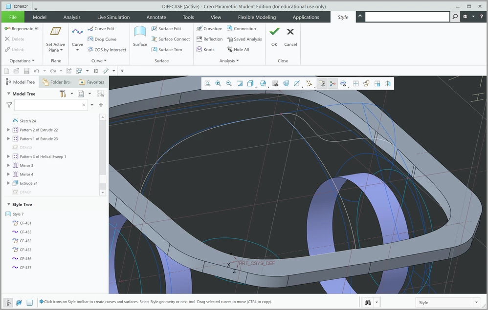

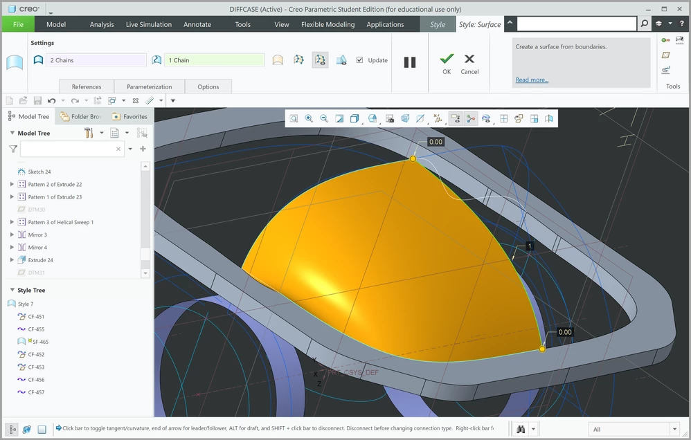

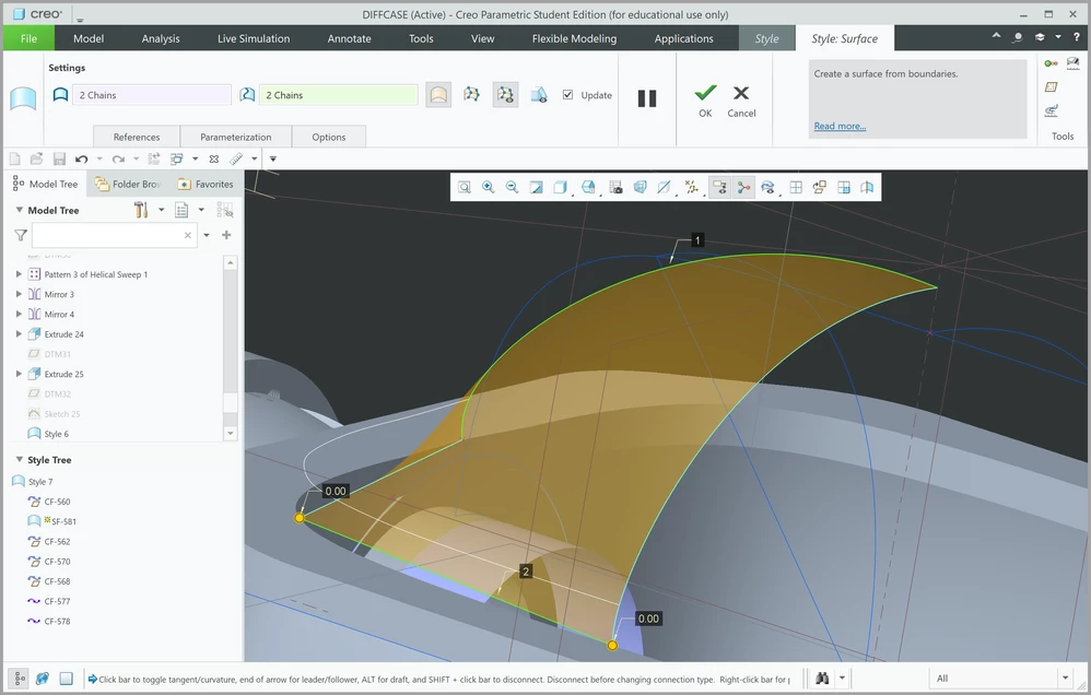

I'm making surfaces in creo right now but I'm having trouble because the sketch I used to create the extrude to which the surface connects to was made with multiple lines. Thus when I create a boundary blend or surface I'm unable to create the surface because it is not continuous.
If you look at the image you can see the surface is incomplete because the curve used from the extruding was from a sketch with multiple lines. Is there a way to merge lines, or project the lines all as one, or create a datum line along the edge?
I'm using the style tool DIFFCASE (Active) - Creo Parametric Student Edition (for educational use only) 2021-04-02 5_13_02 PM.pngusing style to create the surfaces. DIFFCASE (Active) - Creo Parametric Student Edition (for educational use only) 2021-04-02 12_45_45 AM.pngDIFFCASE (Active) - Creo Parametric Student Edition (for educational use only) 2021-04-02 12_46_15 AM.png

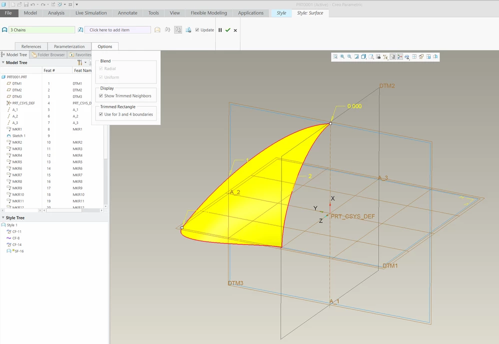

Creating a 3 sided surface is not a best practice using boundary blend or ISDX. If you are going to do it, I would strongly suggest using ISDX and selecting the option to create it using a rectangle which is trimmed option. The software will create a 4 sided surface and trim it for you. It is under the options tab in ISDX as shown below.
Create two 3 side surfaces using the same curves and build it both with and without the trim rectangle option and look at the offset mesh and Gaussian curvature to observe the difference.

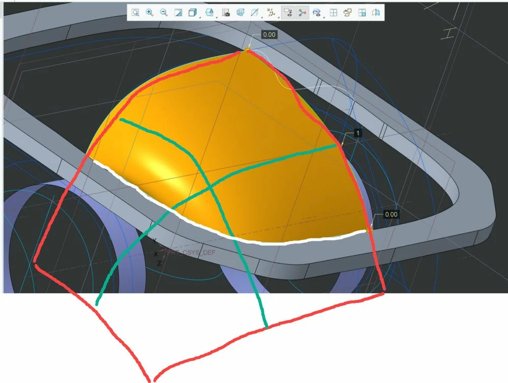

I will get to the curves question. It looks like you are attempting to build a surface that is 3 sided, that is not a good idea. You should build a 4 sided surface and trim it to achieve the 3 side shape shown in your pictures. It also appear you are using 2 boundary curves with an internal curve in your last picture which is not a good way to create this geometry. If you get it to regenerate successfully it will almost certainly not offset to a thickness if needed downstream. Look at the Guassian curvature if you do create it and look at the pointy vertex corner of the surface. Connecting anything to that boundary will also likely be problematic.
For style curves you should directly build the 4 external boundary curves and then add internal curves if needed to control topology inside the boundary. These curves can be built with core Creo features or Style curves and can be mixed in surface construction within style features. When selecting the curves you can use the selection paradigms (chains, loops etc.) to combine/trim curves to define the boundaries. If you are not familiar with this refer to the Creo quick reference card for selection tips.
In the picture immediately below a concept for a curve network to create your geometry is shown. Red represent the 4 boundary curves, green are internal curves should they be needed and the white shows the curve to trim after the 4 sided surface is built. In your case it looks like the flange is planar so you can trim the surface with a plane to get your 3 sided surface quilt and you would not need to create the white curve. I do not think you need the green ones either for you geometry. You also need to pay attention to curve connection and continuity in anticipation of joining other surfaces needed to create solid geometry and thicken it. Take this as a general approach to get a 3 sided surface as matching the opening in the flange is probably not going to work using a single 4 side surface because of the fillet in the corner.
Trim 4 side surf to get 3 side surfTrim 4 side surf to get 3 side surf

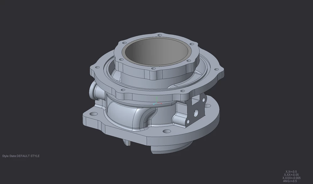

The picture below is a simple example of a cast & machined cylinder design that is water cooled and has internal water passages as well as the porting passages for combustion, all built without using style features. You can get pretty complex topology using the core feature set.
Cast/machined cylinder with linerCast/machined cylinder with liner

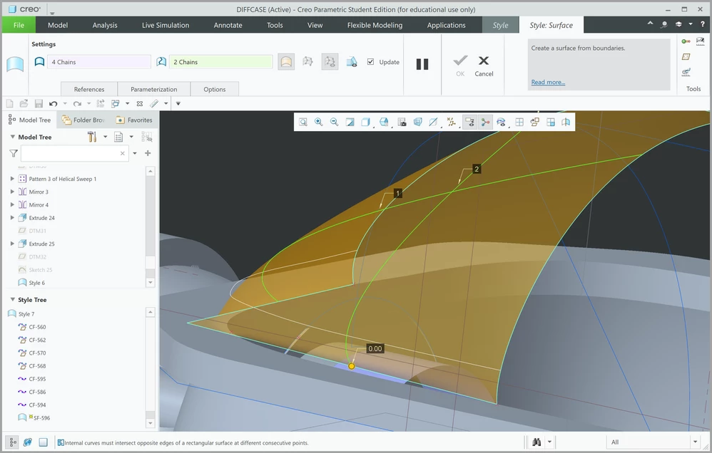

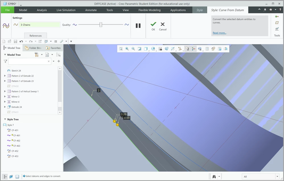

here's were I'm at, definitely my biggest road block I've had in Creo, been working on this issue for many hours
DIFFCASE (Active) - Creo Parametric Student Edition (for educational use only) 2021-04-03 1_15_50 PM.pngDIFFCASE (Active) - Creo Parametric Student Edition (for educational use only) 2021-04-03 1_26_30 PM.png
Yes three sides doesn't thicken so I tried what you suggested but I can't get the surface to meet the curve that I would use to trim as seen above.
also for this particular part of the build it includes wavy curves that (I don't think) aren't obtainable with core features.
