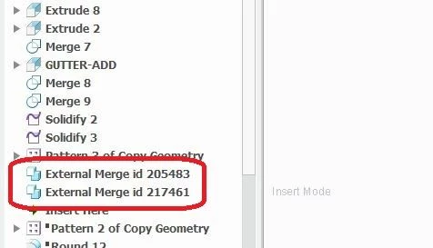

I just reviewed a model with 2 nearly identical merge/inheritance features.  I discovered that one of these models was not updated to the new model which would have been a terrible costly mistake had I not noticed the small difference prior to my model release.
My problem is this:  When inserting the merge/inheritance feature it assigns a completely random number to what it inserts.  I can not identify a problem in my model tree, but I really should be able too.
This is how the models come in.
My question is whether there is a setting that would retain the model name of that which is inserted?  Below is the number I would like in the tree.
I can always rename this after import, but even here a mistake could be made.
Please let me know if I can retain the model name on import.  If not I will submit this request as an idea.  There is no reason  this shouldn't be possible.  In our former CAD system this was no problem.  I was a few clicks away from costing our company dearly.  This can be avoided.

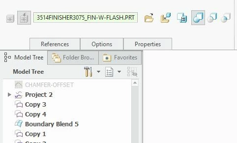

Using the reference viewer you can access the name of the parent object driving the inheritance feature. In theory you should be able to use Toolkit or J-link to write a program which can read the parent object name and assign that name to the inheritance feature. Investigating model check functionality to see if that could support reading and assigning the names may prove fruitful.

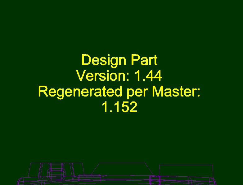

If you are using windchill, you can make use of annotation to display the version of the reference part used in the last regeneration. With a glance, you can tell if your part is outdated. Does this work for you?

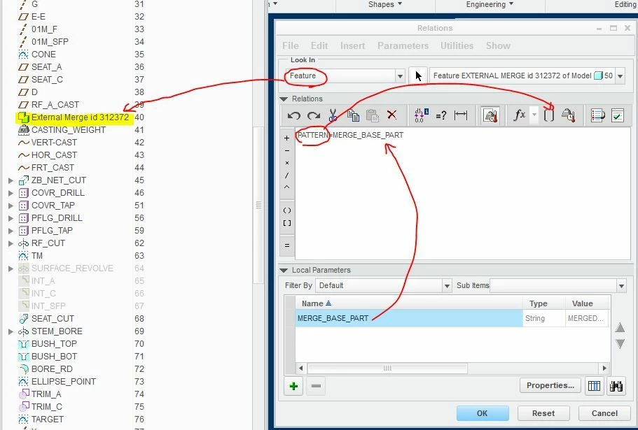

December 19, 2018
you can use relation/feature
on merged part:
merge= merge_base_part
(merge_base_part is a local parameter)
note: create parameter "merge" before writing the relation.
it will take the file name.

December 19, 2018
I would also add in relation/part to avoid any past manual input error
(by experience) this:
merge=" "
IF merge==" "
merge="-"
I hope this helps you.
