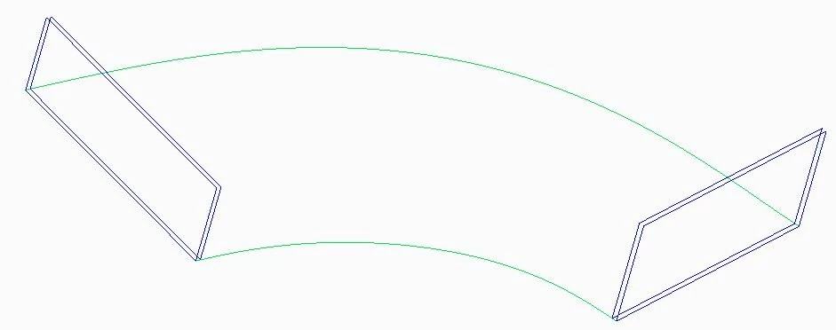

I am struggling on something that is extremely simple.  I need to match geometry built originally by customer as a bi-rail loft.  The sections are quite simple but the solution to this is eluding me.
Here is the frame I have to start with.

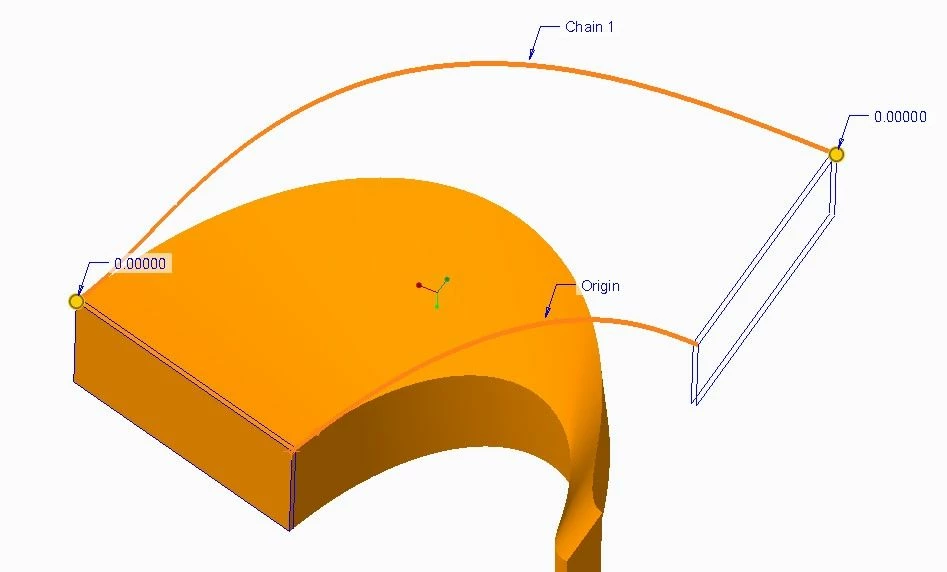

My 1st inclination was to attempt this as a Swept Blend.  I constructed this by choosing 2 reference curves.  As seen below the main reference curve looks great but the solid totally misses the secondary rail.

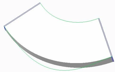

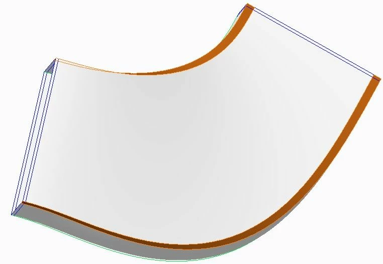

Another method that I've tried is through using a Boundary Blend.  This would work if the side surfaces didn't want to become the top surface going around the sweep.  I tried playing around with Control Points but in this specific instance it appears that they don't work properly.

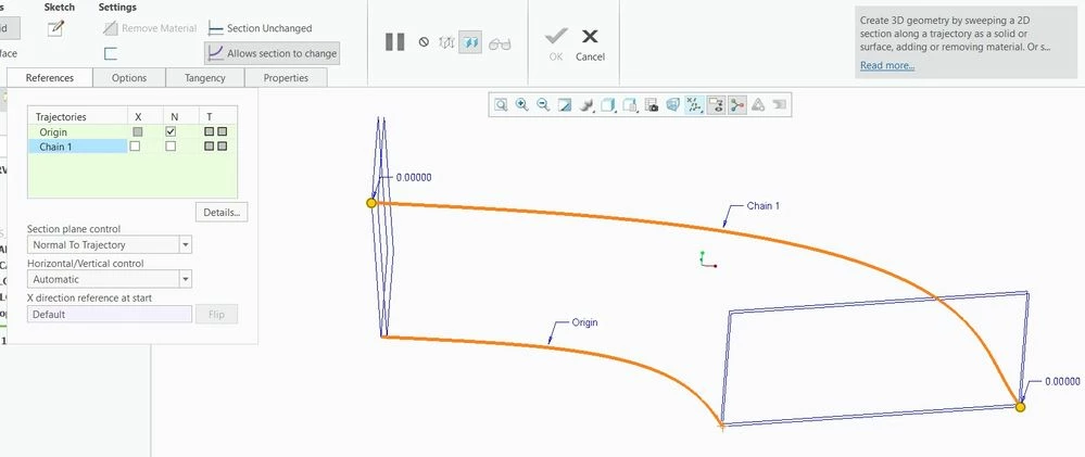

I'd recommend for you to utilize variable section sweep.
You can add trajectories other than the origin to your sweep and use those to drive the cross-section (use CTRL key after your origin trajectory is defined)

I believe I tried this as a Variable Section Sweep.
This is what happens.  I tried different settings.

Since yesterday's post I was able to successfully build the boundary blend without kinks but it did not match up with the solid shape that it should represent.  The rail side and end frames were perfect but the opposing depth was considerably short of what the geometry I need to match with is.  (I was able to figure out how to use the Control Points in this application).
