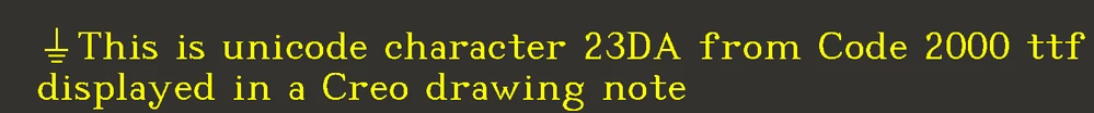

Need to put an Earth Ground symbol engraving on a sheet metal piece
As the title says, i need to put an earth ground symbol engraving on a sheet metal piece, only problem ist, the symbol is unicode, and doesnt show up when i put a text engraving on the workpiece. only thing that shows is a square because the program doesnt know the symbol. any suggestions on how to solve this issue?

Sketching the symbol is not required. You can use unicode character definitions in notes.
tbraxton
December 1, 2021

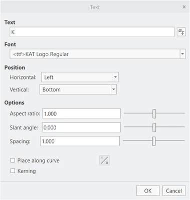

It is possible to use unicode characters in text strings within Creo. You will need to load a true type font (.ttf) that supports the unicode characters required.
Native fonts do not support UNICODE
Hence no mapping file exists between the native fonts and unicodes
Use a true type font instead, that supports unicode
This example illustrates an application where a logo is defined within a ttf font file.

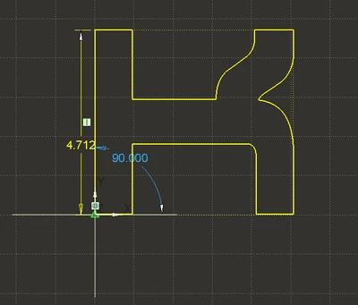

If you use a character like this, can you also engrave it? I seem to recall trying to use some nice characters in my marking "text" and having the engraving sequence fail...I've had engraving sequences fail because I had the audacity to use a comma in them...
tbraxton
December 1, 2021
I have used .ttf logo definitions on many production designs made using injection molding, stamping, electroforming. I have not had any tool design or fabrication feedback that it was a problem. I have logo designs for the different processes so that a molded logo is not identical geometry to a stamped version as an example.

Hey everyone, i guess i was a bit to fast on accepting sketching out as final answer, as i found this after a lot of research, which is basically exactly my problem, and after following the steps it also works now in text
