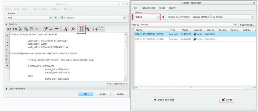

I just ran across two new parameters in sheet metal design :SMT_FLAT_PATTERN_HEIGHT and _WIDTH...Anyone know how to use these? I tried addting the relation that is specified in CS162831 and no luck. Thanks for the help

When you are adding the parameter to the relations, make sure your are tying it to the feature.

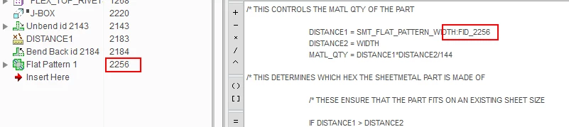

Or you can tie it to the feature ID manually.
[cid:image006.png@01D00581.C54CD010]
Either way it should look like the about in your relations. You MUST include the ":FID_xxxx" to tie it back to the features parameters or it will be looking for the parameters in the overall part and won't find it.
