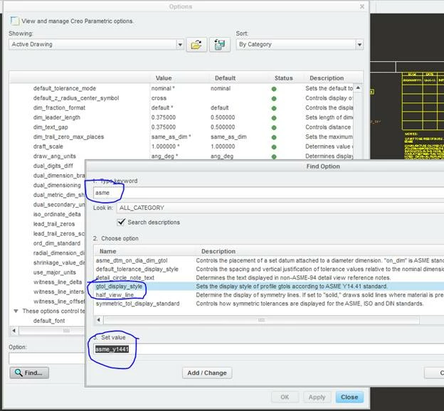

A new symbol, circle U, was added to profile tolerance. In the past, a design engineer wanting to specify an unequal profile tolerance on the drawing would draw a chain line in the applicable area. Two arrows were shown to displace the tolerance zone. In the new standard, the circle U symbol follows the toleranced value in the profile feature-control frame. This announces that an unequal tolerance is in effect.
Is there some way to add this to the interface?

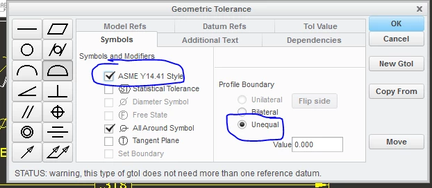

April 2, 2014
A circle U is used in ASME, ASME Y14.41-2003 to be exact.It refers to the distance from the surface a profile tolerance is offset. A distance of 0.000 means that the tolerance is bilateral.This does away with having to draw a phantom line to denote which side a profile tolerance is applied to.
If its not a standard in the ProE drawing call out make a symbol

April 2, 2014
You can turn this on in the drawing options.
ASME Y14.41
Circle U and other ASME Y14.41 settings
File-> Prepare-> Drawing Properties ->Detail Options

April 2, 2014
Ahh, Creo or Creo 2
