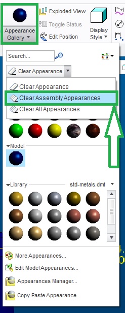

Hello Carl Worthington
the key to solve your problem can be hide under "Clear_assembly_appearances". This button is active only in assembly mode, when some colors has been applied in assembly. See following picture.
Hope it helps...
Milan
