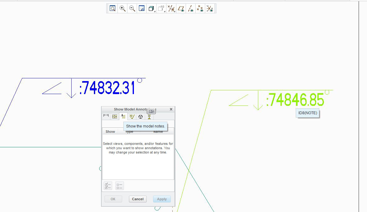

When I show the bend angle note in a drawing of a sheetmetal part, I cant remove the decimals (and create an integer) by adding [.0] to the note, it just shows "[.0]"
Any suggestions how to solve this without manually creating a note (that is not parametric)?

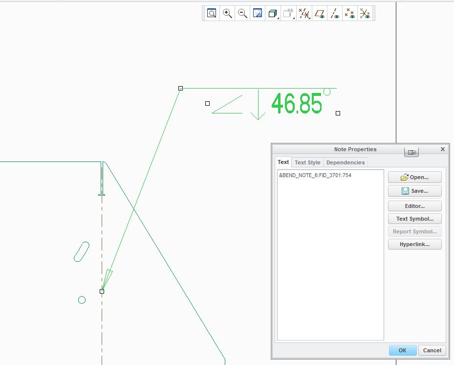

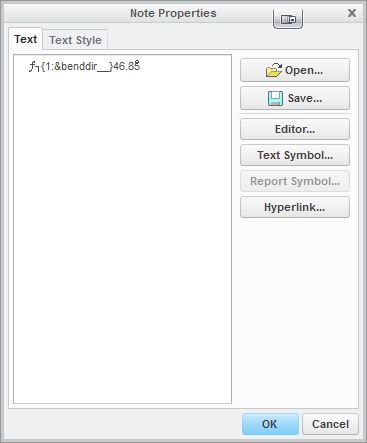

The thing is; these notes are generated automatically in drawing for a flat pattern (instance) of a sheetmetal part. I do not know how to refer to these notes in part mode or how to find them. I can only see them in drawing mode. In the image below you can see what happened when I switched dimensions. It still shows the angle but with a number in front.

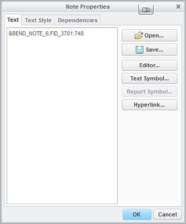

when I click on "edit value" after rightclick on a note, I see this:
when I click on "properties" after rightclick on a note, I see this:
Adding [.0] does not work, it just shows "[.0]" Any suggestions how to easily round the angle value?
