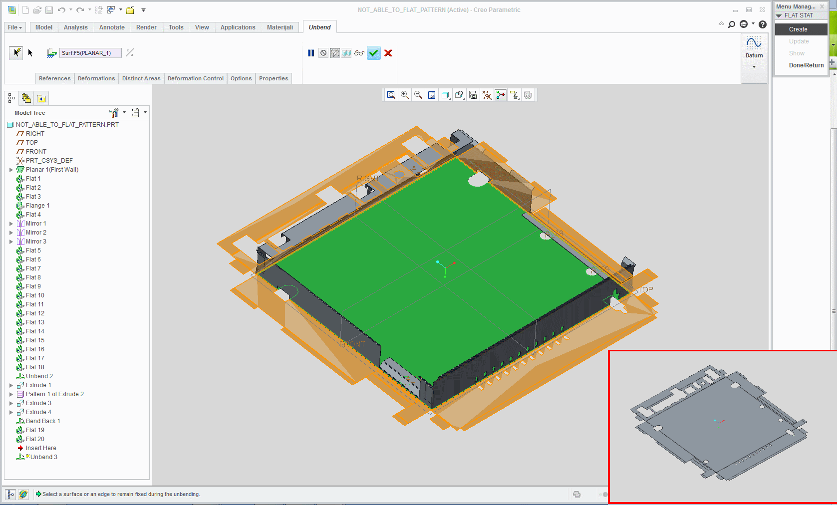

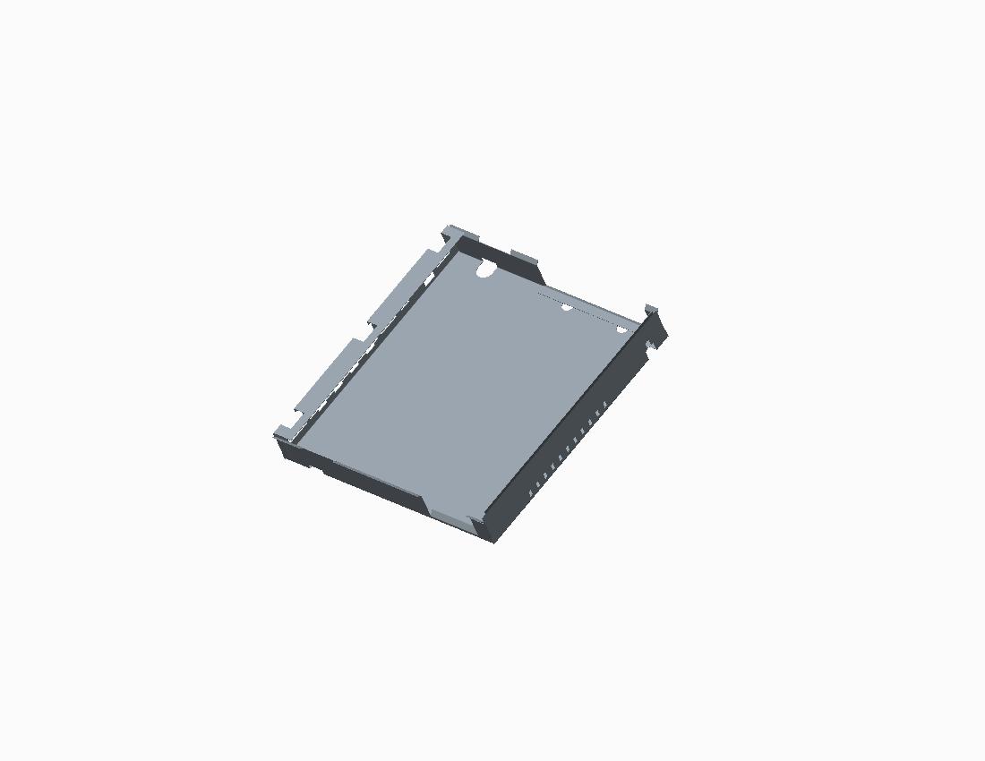

not able to flat pattern this sheetmetal part in creo 2.0..the unique this is that it does unbend..but does not flat pattern. i have also attached the part file below.
Best answer by TomD.inPDX
Change the Relief on Flat 1 and 3 to Rectangular

Flattens fine on my Creo 2.0. Im on M030 if that helps. Tho i use macro for create flatten form. i don`t go to flat pattern preview. And you are right my flat pattern preview won`t flatten it. Just pull out create flat pattern button on ribbon and it should work. Seems like some kind of bug.
January 24, 2013
mine is M010......and in M010 in flat pattern ...removing "merge colocated side surfaces" in "options tab" does the trick...but it still does not flatten in the new flatten preview option.
January 24, 2013
Can you maybe update your Creo to M030?
I can send you flat part if its any use.
