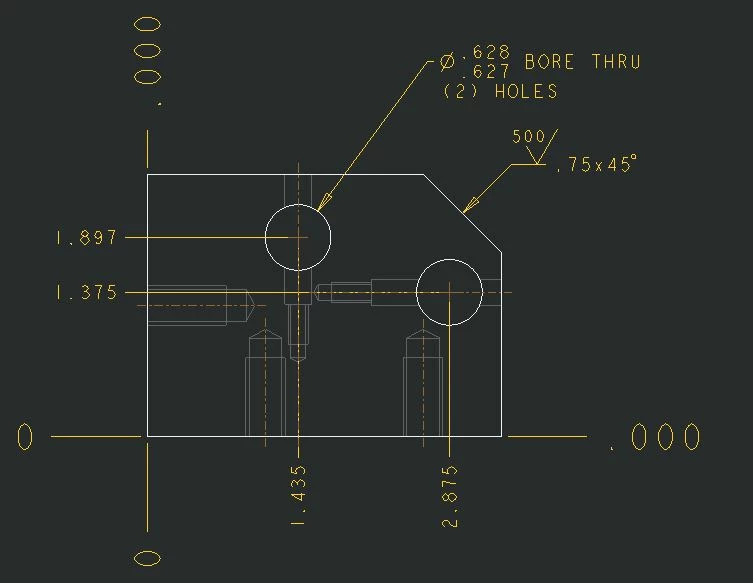

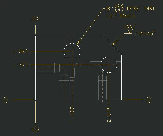

I am having an issue with my ordinate dimensions. We always put a second zero on all parts we dimension. The first is the ordinate baseline, the second is simply a dimension based off the baseline on the same line as the zero so it has a dimension of 0.000 we then set both zeros to a larger text size and zero decimal places. See image "corect zero.jpg". Everything looks right when we are done, we regenerate and save the document. The problem arises when I reopen the document. The second zero does not hold the correct number of decimal places. Instead of 0 which I would expect, it comes in as either 0.000 or 0.000000000001. See image "wrong zero.jpg". When I go to the properties of the dimension it already says it is set to 0 decimal places. I figure this has to be some sort of config or drawing propery setting but I have been unable to figure it out. I would appreciate any help that can be provided.

I would suggest filing a support case and submit the file you are working with to PTC. Things changing between save/close and reopen is a serious issue.
January 30, 2014
Have you checked to see if there are two dimensions on top of each other? Something else to check is the round dimension value setting.
