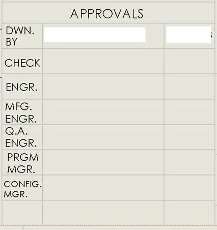

Upper right corner of drawing format. The overwriting on the format is an auto stamp added after the fact by our PDM folks.

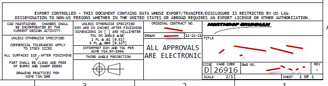

Lower left corner of drawing format. The ALL APPROVALS box used to have all the sign offs in it.
