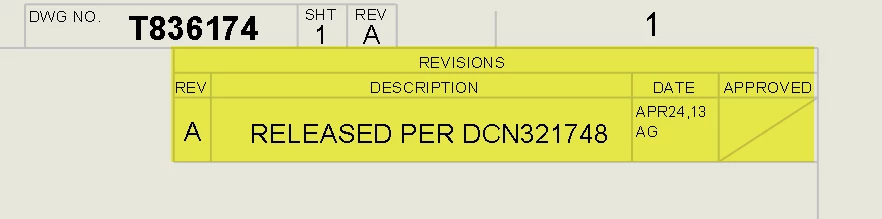

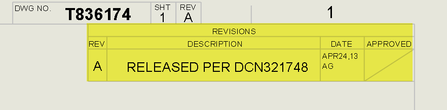

Is there a Drafting Standard that states the Revision Block shall only be shown on the First Sheet?
Thank you.
-Art

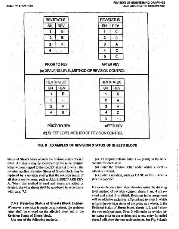

    June 6, 2013
    ASME Y14.1 (and Y14.1M) cover formats. It doesn't specify in there that each sheet shall have its own rev block. It does however cover the use of a table on sheet one describing what revision each sheet is at. ASME also requires that each sheet clearly indicate the revision.
    In my experience, the rev block is identical on all sheets. If one is documenting the changes within the rev block, this is probably not the best choice. If one is referencing an outside document where all the changes are detailed, this becomes much more feasible.
    In Reply to Art Garibay:
    Thank you.
    -Art

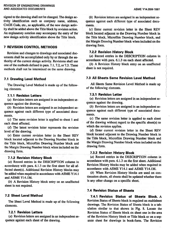

    June 6, 2013
    ASME 14.35, Section 7 (Revision Control Methods) provides several methods for multi-sheet Revision.
    [cid:image004.png@01CE62DB.09E31540]
    [cid:image005.png@01CE62DB.09E31540]

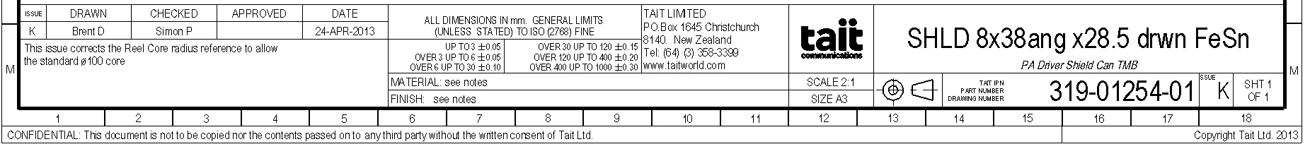

    Hi Art,
    I have replied to this in email as for some reason I could not find it in
    the forum.
    I like simplicity and since I never trained as a draftsman (though I have
    made drawings for many years including from a drawing board) I have always
    seen these as simply documentation for what I want to make. I emphasise
    clarity over what standards say though in some industries you are bound by
    standards requirements. (Shock! horror! Queue "march to the scaffold"-
    Berlioz <).">http://www.youtube.com/watch?v=pK0skj1HNzY>).
    Where all this is getting to is that our drawing templates call up drawing
    formats that have the Title Block totally populated from Parameters and
    Notes within the 3D model (Part or Assembly). I even do the no-no of
    having the revision (issue for us) in two places in the title block but as
    these are populated from one source I don't care. In multi sheet drawings
    the sheets are the same as the first sheet though we can have a mix of
    sizes if really necessary; all are auto-populated so the only chance for
    error is if the Designer does not fill in the Parameters and Notes
    correctly in the model.
    I have put an example from an A3 drawing that I am presently working on
    (and not finished). You can see Issue K on the far left and also on the
    right after the part number. Other non standard things are use of upper
    and lower case text and Arial narrow True-Type font. All in the name of
    clarity.
    Good luck!
    *Brent Drysdale*
    *Senior Design Engineer*
    Tait Communications

    Group,
    I've seen two or three ways of revving drawing sheets over the years. One
    is to control each sheet separately, this was originally driven by our
    customers requirements and may be considered old school thinking in this
    day and age. The pragmatic part of this thinking is driven by the ease of
    seeing what was changed quickly by looking at the drawing. Now days we
    have tools to compare different revisions of drawings with differences
    highlighted in the color of your choice.
    Over the years our company has assimilated other companies, some of them
    had the culture that the entire document should be at the same revision.
    So our standards were broadened to accept both methods of controlling
    revisions on multi sheet drawings.
    In the day that drawings are becoming more and more connected databases,
    residing in a single file, the method of making all sheets the same
    revision makes sense more and more. I do not think enough time has passed
    however to remove the rev status of sheets block on the first sheet and the
    individual rev status blocks on each sheet as is promulgated in the ASME
    specs... some poor soul will still end up working from a paper copy of a
    drawing and wonder.
    I'd say leave it alone for now and if you describe something you did on
    sheet 3 in the block I say that's good. If you say the particular sheet
    was revised by some other document number I'd say that was good. If you
    say 'SEE SHEET 1' for the current revision status, I'd say that was good
    too. ...provided that is what you say you do in your work instructions,
    policies and procedures or standard guidelines... AND as long as your
    partners and customers are in agreement of the method you use. Three
    things I've learned over the years is that consistency counts, the document
    that describes your general guidelines counts and above all, your customer
    is always right.
    I think best revision practice now days is to use a metadata tag, that is
    watched like a hawk by Configuration Management. That metadata tag
    determines the revision, and is displayed in the revision block along with
    the metadata tag containing the identifying number of the document making
    the change displayed in the revision block in the format of each drawing.
