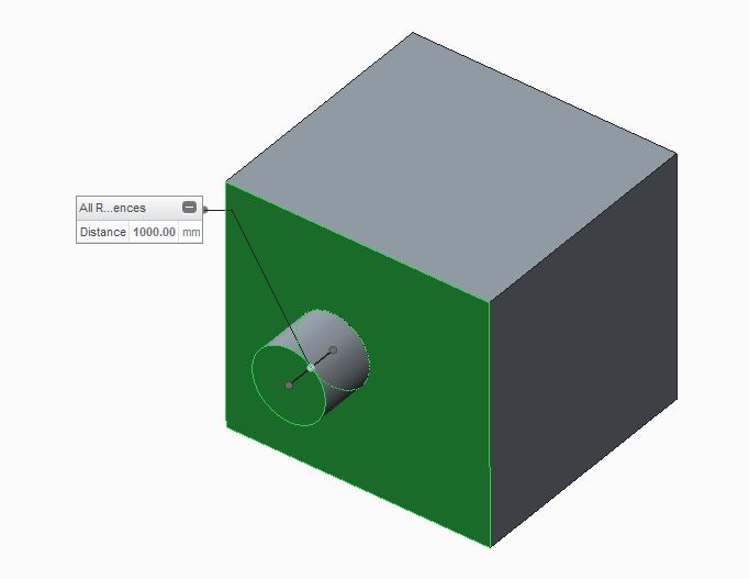

actually wat I was asking was,
wen I offset a surface, the extrude done from that surface should also move na.. but in real case that's not happening.
like wen i go bfore the extude and offset that surface, the extrude remains same.
it's happening that the extrude remains there itself and the surface only moves.

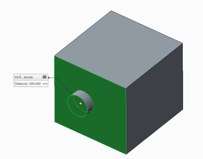

actually i hope u alll didnt get wat i'm asking here..
as u see in the above pics,
the cyllinder is extruded from the surface in first fig., after that i take insert mode before that cyllinder extrude and select the surface and give offset 500mm.
so wat i'm asking is wen i go bfore that cylinder extrude and offset the surface to 500mm then wen i resume the extrude it shld be still from that surface only rite ( means the length of cylinder should be 1000mm only )
if NO, then it is equivalent to keepting insert mode after the cylinder extrude and selecting the surface and offseting.
wi both cases are same is my question.
July 7, 2015
Just hold down "CTRL" and pick both the square surface and the round surface on top of the extrude.  Then they will both offset together.
July 7, 2015
When the surface is offset, it gets a new surface ID. Creo "remembers" the old surface ID and its location and that your extrude was created on the old surface, so it continues to create it there.  If it didn't, the extrude would fail because the old surface is gone.  You could argue that it should fail if the surface is gone, but that's not how it works.  (in fact, years ago, it would fail in this situation and our models would fail constantly as a result.  Trust me, this is better.)
You'll need to redefine or reroute ("edit references") your extrude to refer to the new surface.

but wat i'm asking is, then wat is the difference of offseting the surface before and after that cyllinder extrude ????
both giving same results.
my arguement is wen u select the surface after that extrude, only the surface other that the extruded part will get offsetted.
but if u go bfore the extrude and select the surface, then u'll be selecting the complete surface rite. so the extrude shld also be offsetted.
simple example is like,
u have a wall i ur room and u have a wall clock and a AC fitted to wall's surface.
now
if u remove the clock and AC, move the wall and then fit clock and AC.
or
u keep clock and AC and add some wall material,then only it will submerg the clock and AC..
hope u got my point.
July 8, 2015
I would agree that this "feels" like it shouldn't work this way, but it does. it seems like you are moving the surface, not replacing it. I'd say this is a good spot for an enhancement request, either changing the current functionality or creating the option to maintain the surface ID during the offset.
Nonetheless, understanding why can help you work around it in the future.
