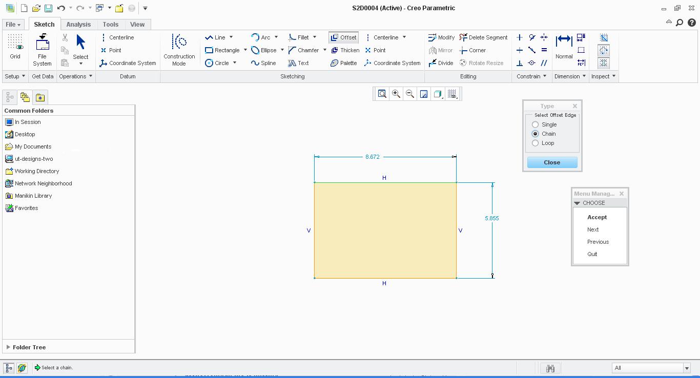

just checked the offset sketch bug in creo 2.0 is still there in M030 also. below is the picture..as you can see it does not highlight the chain. could somebody please show it to Creo developers.offset+sketch.JPG

You have to select 2 edges, and then you can toggle through the solutions with the "next" option. Accept and you will get annoying message telling you the endpoints of the chain are coincident and asks if you want to convert them to a loop. I don't really get that one.
Of course, you can always select the loop too.

HI,
the issue is only when selecting sketch entity..with edges the option works fine.

I can reproduce the problem. I add some details for other users.
1.]
The problem is related ONLY to highlighting current variant of offset, when user selects two sketched entities.
When user selects two sketched entities -> Creo does not offer variant no.1.
When user clicks Next -> Creo does not offer variant no.2.
2.]
When user clicks Accept -> Creo is able to create offset entities, but user cannot choose the right variant.
3.]
The problem will not show when user selects two edges.

thanks Martin...that's correct. The issue is only with sketch entity selection. I just want that it is rectified.

Thanks for the clarification.
I was able to offset lines from a sketch if it was a -previous- sketch with all the appropriate highlighting.
When I tried offsetting the edges in the current sketch, the highlighting fails... but the offset for both loop and the second variant of the chain works.
Pretty annoying indeed Have you reported this (again) Rohit?
