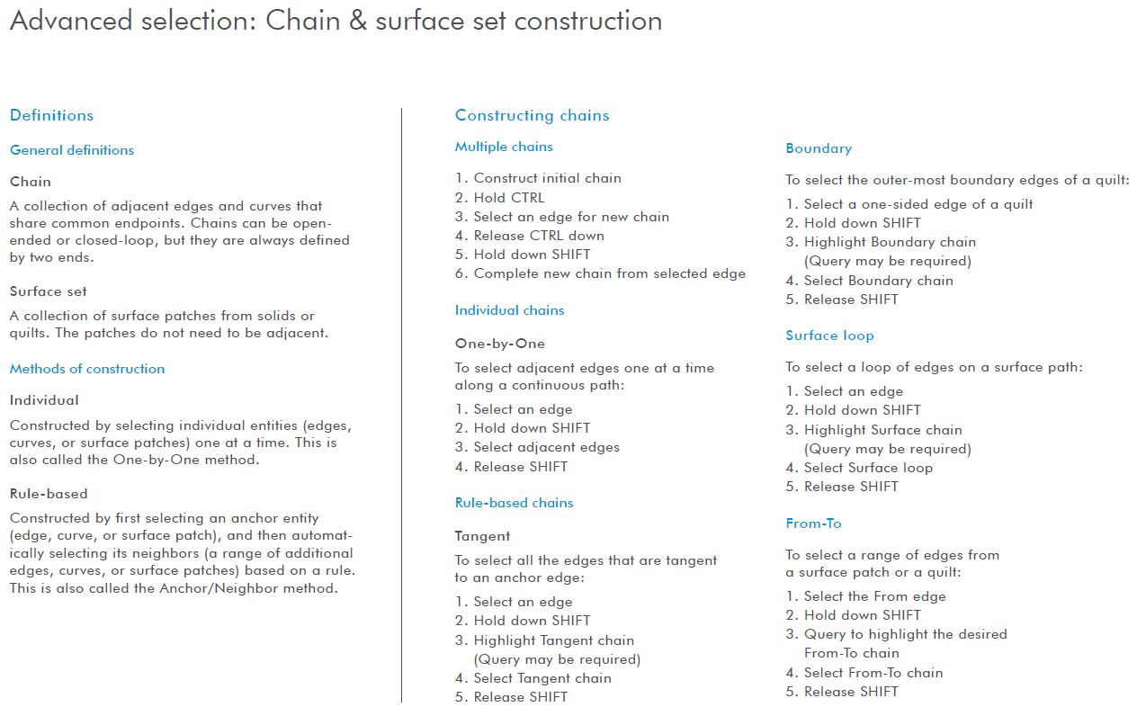

I have never used the offset tool before. I am trying to offset the entire part I am making. Currently, my best way of doing that is to offset each of the individual surfaces separately. Unfortunaterly, it takes a long time and the outcome does not look as nice as I had hoped. Can anyone help me? Does Creo have the capability to offset multiple surfaces at once?

Can you merge the surfaces to offset the quilt instead?

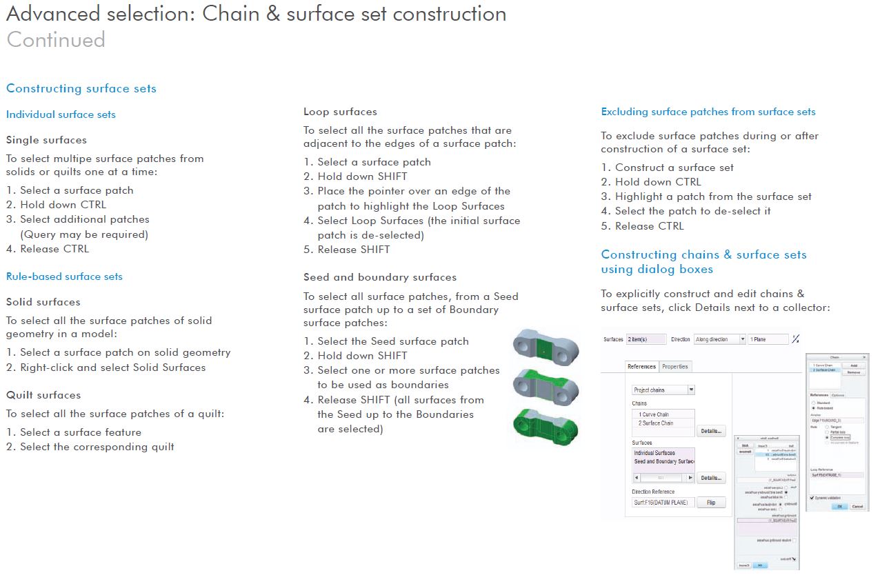

As Antonius says. Alternatively, highlight all surfaces you want and create a copy CTL+C, CTL+V. Then create an offset using the copy. This method also works if you are working with solid geometry only. Change the selection filter to geometry or else use ALT+LMB to select a surface right click it and select all solid surfaces...deselect the ones you don't want by using ALT+CTL+LMB, then create a copy per the above. Watch out for offsetting greater/smaller than your smallest radius/edge distance.
Aug 12, 2013 4:28 PM UTC
Worth noting that you can select all surfaces of a solid or quilt very easily using 'seed and boundary': select a surface, then hold Shift and select the surface again (I think that's right).

Thanks Jonathan. I always forget about seed and boundary. I guess I never used the advanced selection methods enough to get the hang of it...kinda like playing twister with your fingers and brain at the same time.
Images are from the Creo quick reference card.adv_select_0.JPGadv_select_1.JPG
