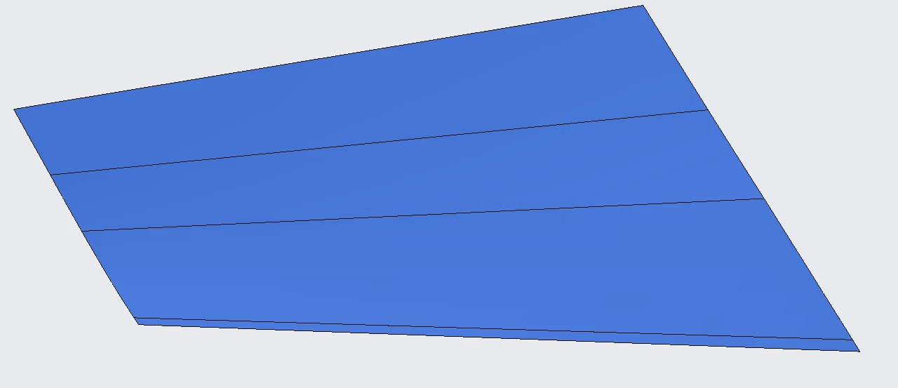

one surface instead four
hello
i have a little problem ; i want to create a single surface instead four is posible ?
i attach picture for better understanding

please describe how did you create the surface.
bcat1-VisitorAuthor
March 12, 2020
i created surface with boundary blend
tbraxton
March 12, 2020
If you used a 4 sided boundary blend then it is one surface. The lines within the boundary are likely the result of changes in the surface properties (isoparms). Not a definitive diagnosis from your picture only, would need to look at the model to be sure.
In order to not get the lines within the boundary you will need to "clean" up your boundary curves.

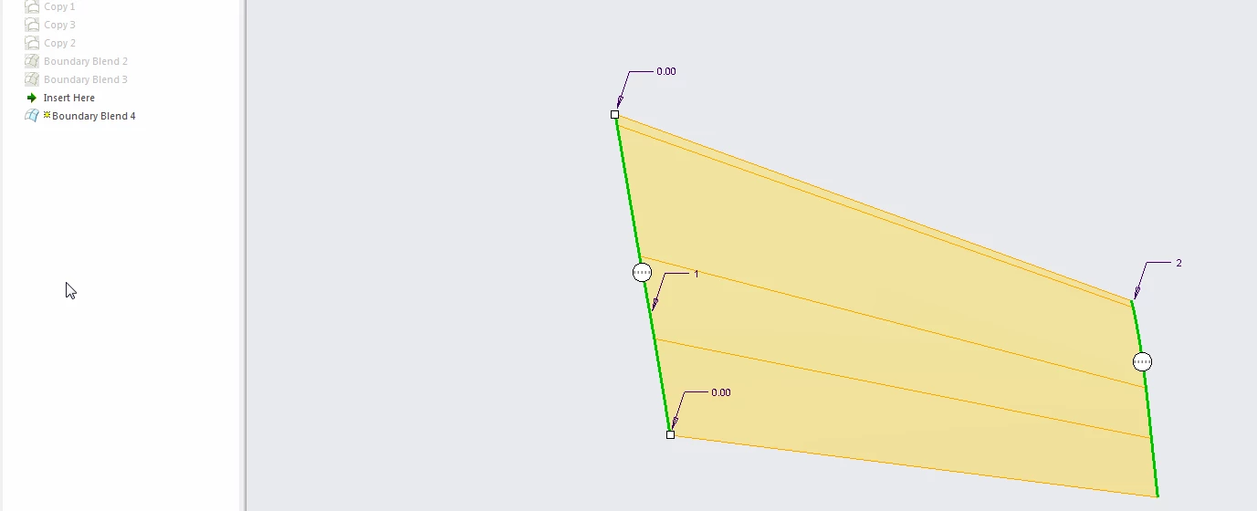

bcat1-VisitorAuthor
March 12, 2020
in the fille 1 is the definition for boundaryblend
in the fille 2 is the result i want if is posible
tbraxton
March 12, 2020
Try the following.
1) Make copies of the boundary curves using approximate option. (if the curve is a linear segment this is not needed)
2) Create the boundary blend using the approximate curves.
BHOoi
March 14, 2020
Could you please provide part file with the curves you used to create that surface? Curve approximation may be one way but it may give you geom check error in the subsequent surface merges. I would like to look at your curves and try it out. Thanks
