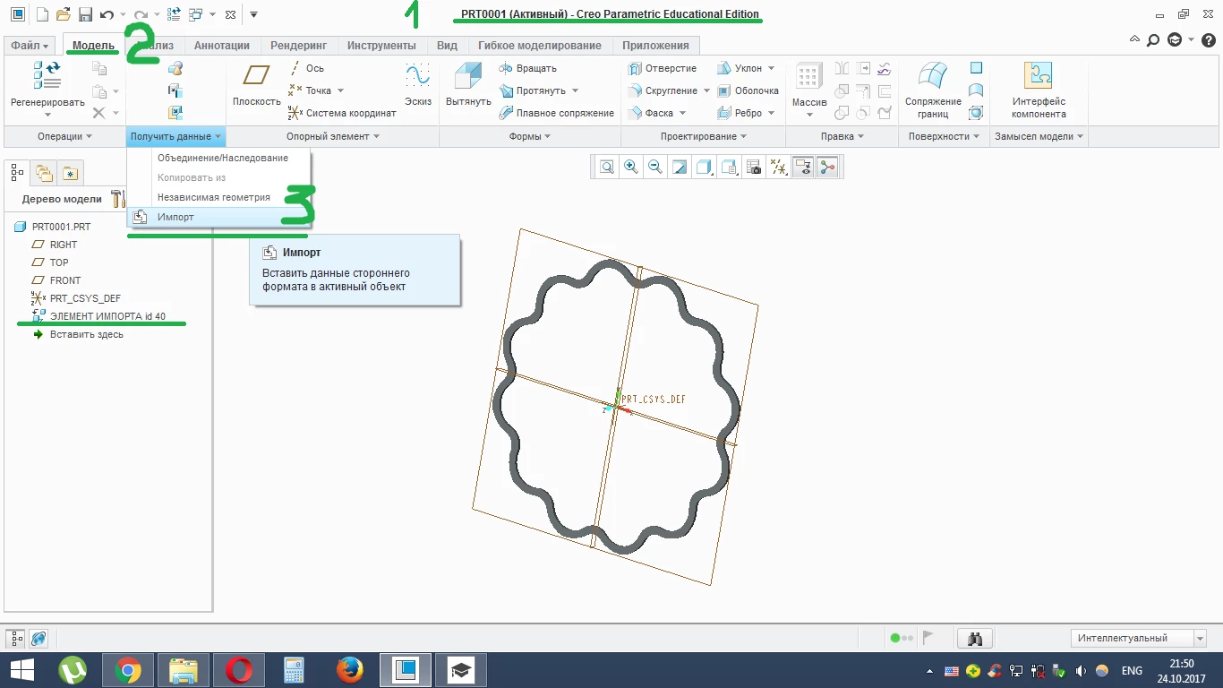

Good afternoon!
If you have a model in STP format, then you need to go to the "Model" tab -> "Get data" (second tab, drop-down menu) -> "Import" to import. Then select the desired STP file, open it, wait for the import, click on the green tick and continue working further.
(from Google tanslate)
I'm using the training version.
Sincerely, Evgrafov Aleksandr.
P.S. If I misunderstood you - describe the issue in more detail. For verification, you can attach any model file created by you to the direct express so that I can try to import the file myself as you need.

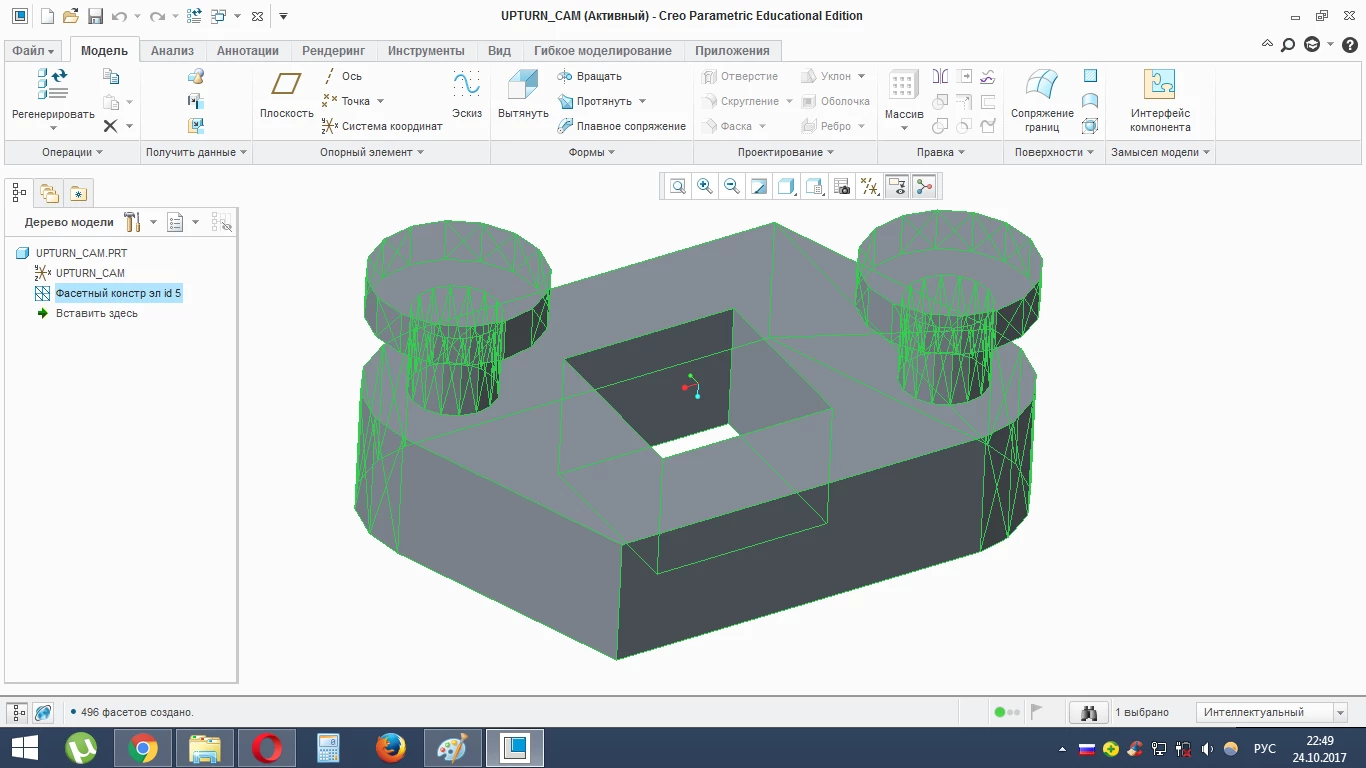

Attached is a sample stl file of a piece he created. Before you attempt to open, you need to rename it as a ".stl". Can you find a way to open this?
Thanks..
October 24, 2017
Look what happened after importing the STL model file.
