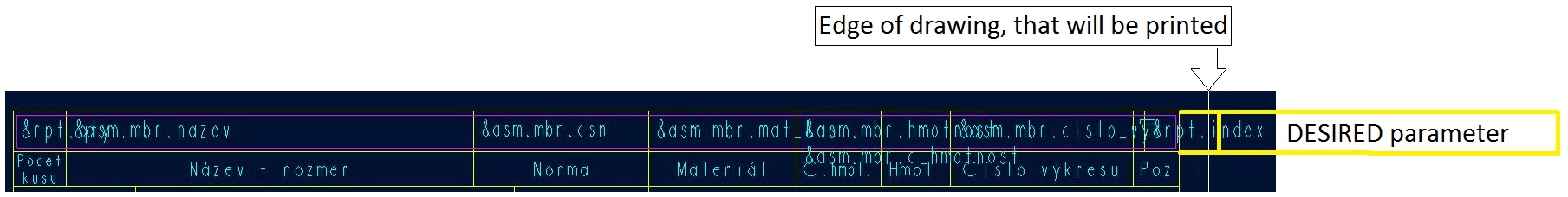

Hello @kbhavsar-3
 don´t know if it´s possible, but can provide you alternative solution.
It´s based on drawing format rearange. ADD DESIRED PARAMETER OUT OF DRAWING SHEET. Than you can edit parameter from drawing space (don´t have to open part - parameters).
See following picture:
At the end you can edit desired parameter directly in drawing space and it will not be pritnted on drawing.
Regards
@mbonka
