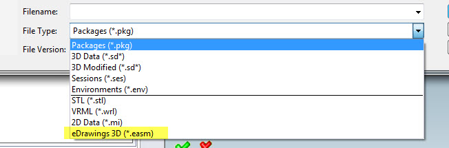

Here is another option. From Creo Elements/Direct Modeling 17.0, you may output a *.PVZ file for Creo View Lite. First you must activate the Data Interface: Click Application>Modules>Data Interfaces>Creo Elements/View. Then click File>Save and set File Type to Creo Elements/View.
November 15, 2013
If your client only needs viewing capability, you have the option from Creo Elements/Direct Modeling 17.0 to output the file as an eDrawings file which can be viewed in the eDrawings free viewer:
If they have a CAD software of their own, you can send them the geometry files through STEP or IGES output which they can probably load in their CAD or CAM software. In CED Modeling 17.0, you need to activate those modules using the menu Applications>Modules>Data Interfaces, then return to the Save dialog and you will have those file types available to save.
If they want full view and measure capability of the native CED Modeling 17.0 package files, then the Creo Elements/Direct 3D Access tool can be purchased from PTC and downloaded from the PTC Support website. Any version equal to or later than CED 3D Access 17.0 will work to open the *.pkg file.

Yes our draftsmen has tried this. But a edrawing of the entire model is too big and makes the edrawing viewer crash. The model was split up in multiple .pkg files that I can all load one by one in 3D access. But the seperate edrawings of these .pkg cannot be combined into one screen... So our client cannot see interfaces between building and equipment, because these are seperate .pkg files.
Anyone else had these problems? crashing the edrawings viewer because model is too big?
