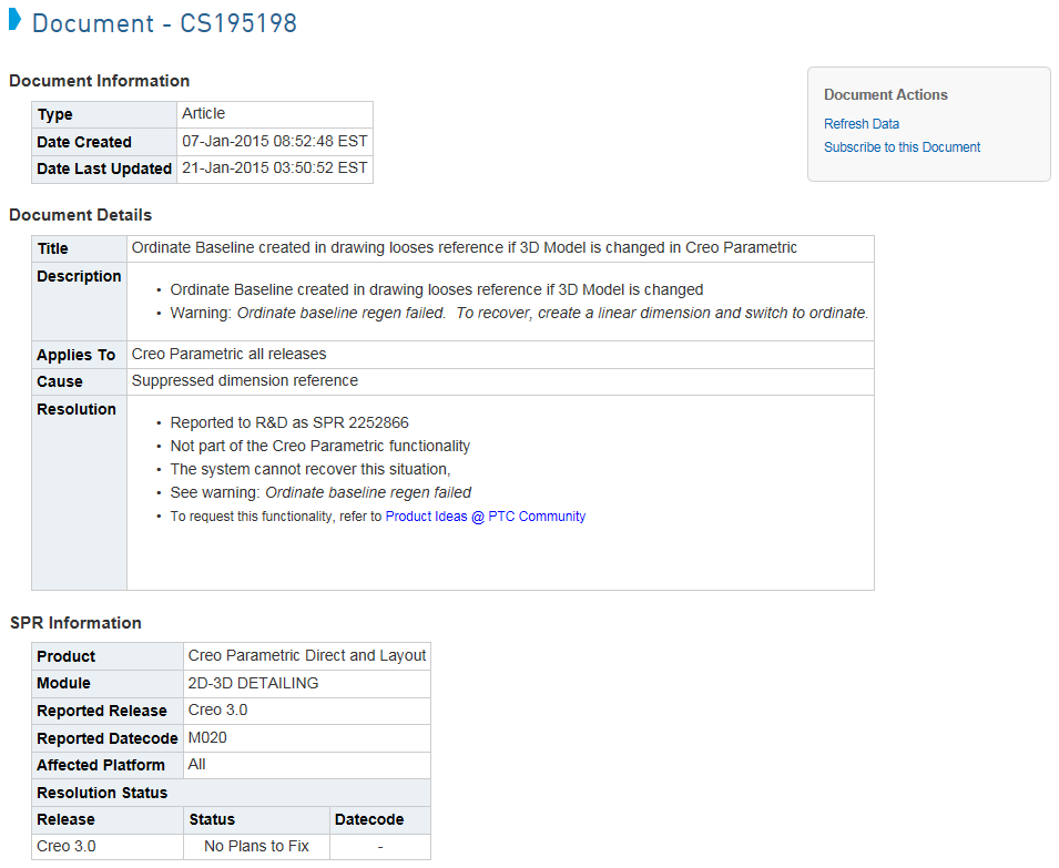

We're having a bit of a struggle with Creo 3 unexpectedly losing ordinate dimension baseline references. (This of course then means ALL the dimensions have to be recreated.)
In the message bar there was this message displayed:
Can this be fixed? I don't know, but I was willing to try.
After trying everything I knew how to do I was convinced it couldn't be done, so I turned to the knowledge base. Sure enough, it talks about this message:
Okay, so maybe just a misleading message. No big deal. But then I found this:

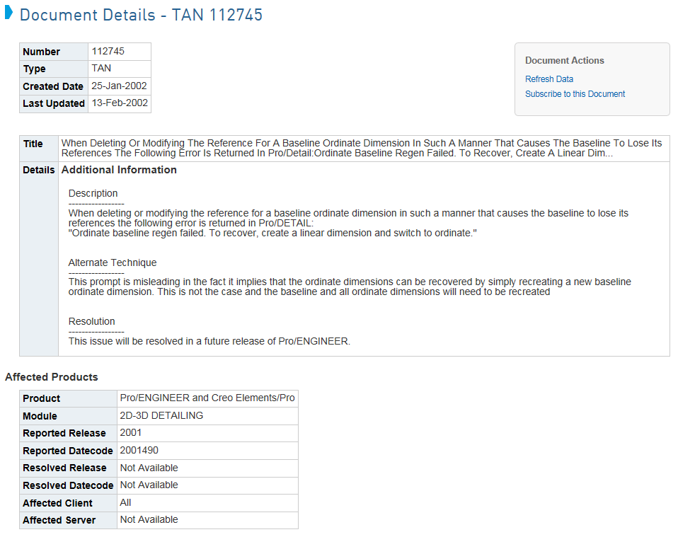

Seriously!?!? This is 13 years old from Pro/e 2001 and lists the exact same misleading error message!
I have totally lost faith in the statement "This issue will be resolved in a future release of Pro/ENGINEER."
Want proof that Creo 3 is still running the guts of Pro/e 2001 (and probably earlier)? There you go.
