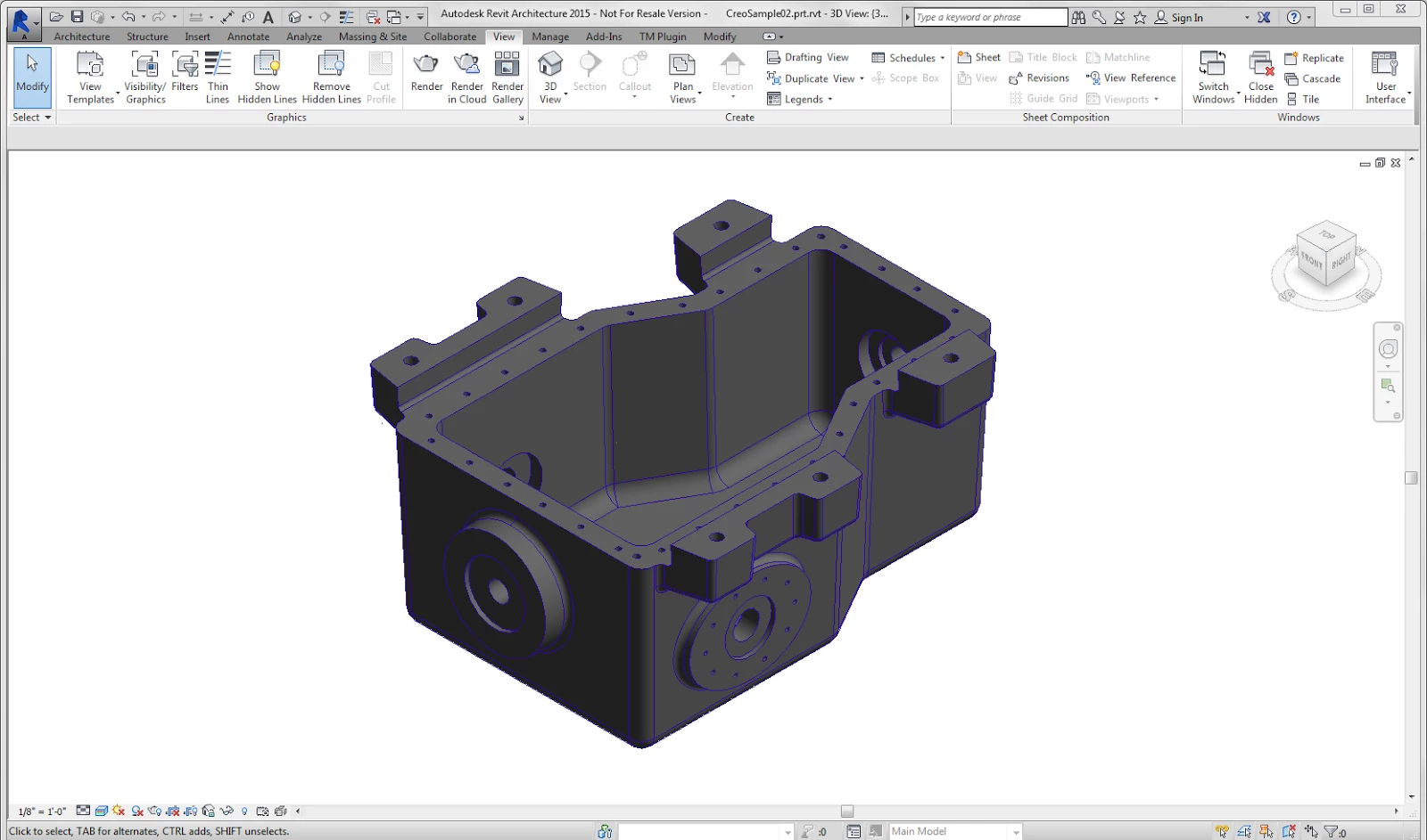

Hi guys! I have been trained in school using Creo 3.0 and there was this cube at the top right hand of the screen where it shows the Top, Bottom, Front, Back, Left and Right views. I just need to simply click on it and it will rotate my part to where I want it to be. Now, the cube is missing from my Creo 4.0 and I have no idea how to get it back. Please help!!
For more info, the cube is at the top right hand side of the part.

That picture is Autodesk Revit. Are you sure you were taught Creo Parametric?

Hi Dave Martin! Thank you for your prompt reply! Yes I was taught using Creo 3.0 Parametric Academic Edition and it had the cube thing at the top right. The picture I used was from Google images as I could not find any other sources to show what I am talking about.

As Dave mentioned, it is not from Creo. It was never a part of Creo. In Creo you can use "Saved Orientations" to select respective orientation

This is an AutoDesk user interface element. I don't recall that it's ever been part of Creo.
