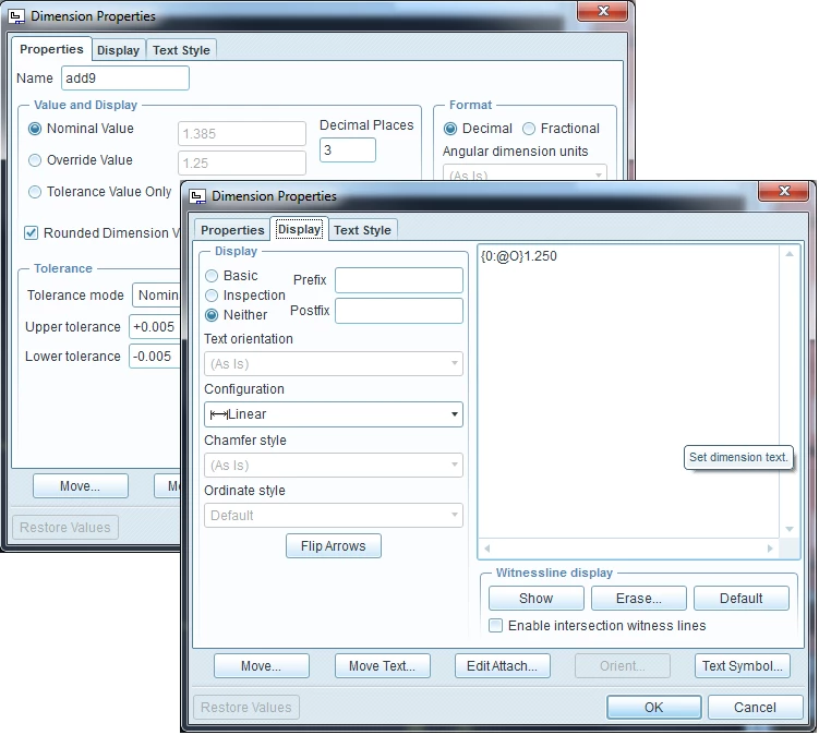

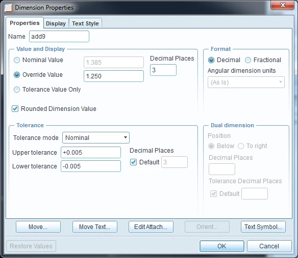

Our checker mentioned that on "ADDED DIMENSIONS" the "Override Value" feature in the Dimension Properties does not get flagged in ModelCheck as an overwritten dimension.

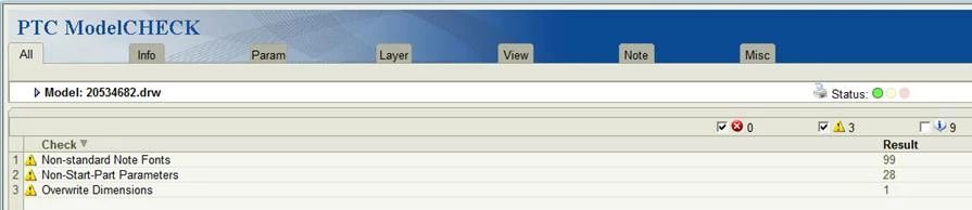

Our previous method, also shown below, would give you a warning message in ModelCheck.
Granted, we generally use 95-100% driven dimensions from the Model, "Added" dimensions can still come into play.
My question is: Is there an option in ModelCheck to identify the overridden dimension? Similar to the "Overwrite Dimensions" previously......
WF5 method that can be used to Override dimensions....
[cid:image001.png@01CD8C0E.E0B34C10]
Previous Method:
[cid:image002.png@01CD8C0F.96F26B00]
[cid:image005.jpg@01CD8C10.60E63F40]
