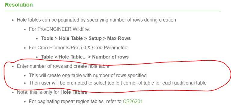

Paginating Hole Table
I am working with Creo 4.0 M60
I am trying to paginate a hole table but am running into the issue of trying to "Set Extent". I get the error message "Could not set extent."

Dale_Rosema
Oct 30, 2019 4:14 PM UTC
Caught a specific wording:
If I create the table with the number of rows I want, that works, but it doesn't see to allow me to change it after it was made (or I can't get back to the menu to set the number of rows).
Dale
TomU
Oct 30, 2019 3:59 PM UTC
This article is for an older version, but might be worth trying:
https://www.ptc.com/en/support/article?n=CS37250
Dale_Rosema
Oct 30, 2019 4:07 PM UTC
It mentions that Paginate with repeat region table.
Is a "Hole Table" considered a repeat region table?
Dale_Rosema
Dale_Rosema23-Emerald IVAuthorAnswer
