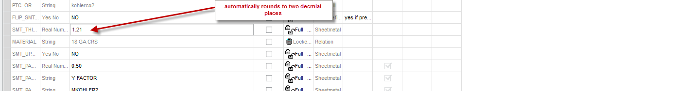

Hey guys,
I am trying to drive some parameters with a number, and it automatically rounds to two decimal places. I would assume there is a way to set this decimal place but I am having a hard time finding it.5-20-2014+8-12-31+AM.png
Thank you!
Brock
Best answer by John.Pryal
Hi, there is a config option Param_dec_places. You the number of decimal places here.
Regards
John
Regards
John

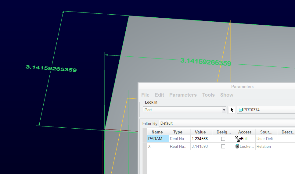

Interesting... By default mine is 6 places but it is truncated as using the parameter in relations is much greater.
in this case, I set x=pi in part relations. I used "x" in the sketch and as a height value of an extrude. Removing the rounding, it has more than 6 digit accuracy.
