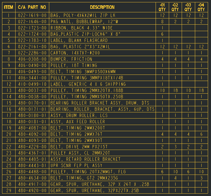

I have a matrix table, fully parametric. It has parts (-01 through -04) and 29 items. Some of these items should not show as numerical, but rather as A/R in the table as their quantities are less than one.
On other tables I use
/* determines quantity
IF asm_mbr_ca_part_no == "PART#"
   NUM = "QTY"
ENDIF
and just edit "part#" and "qty" to what I need and update the table and it works. But on this parametric table I see this (as default):
IF ASM_MBR_TYPE == "BULK ITEM"
NUM = "A/R"
ELSE
LOST SYMBOL= rpt_qty
error Invalid left side of assignment
ENDIF
I cannot change "bulk item" to the part number needed nor can I add my own command (as shown above) to make the table show the amount I need. There is something somewhere that Creo does not like but I just don't know what it is. We are just starting to use parametric matrix tables and nobody here knows what is going on.

This is what my table looks like at the moment. Items 3, 5 and 12 should have a quantity of A/R and I also would like to add a qty of "0" to the empty spaces in the table, if possible.
August 2, 2016
try:
NUM=rpt_qty
   NUM = "QTY"
ENDIF
NUM = "A/R"
ENDIF
This way, NUM is given a value, and it is changed if it meets certain criteria.

That, at least, got rid of the error, but changed nothing in the table. Does it have something to do with the relation of -01,-02... because they each reference a different model in a family tree? Or maybe because there are more than one bulk item in the drawing, meaning that not only the items I want the qty to change, but others who have a set qty of 1 are reading as bulk items.
