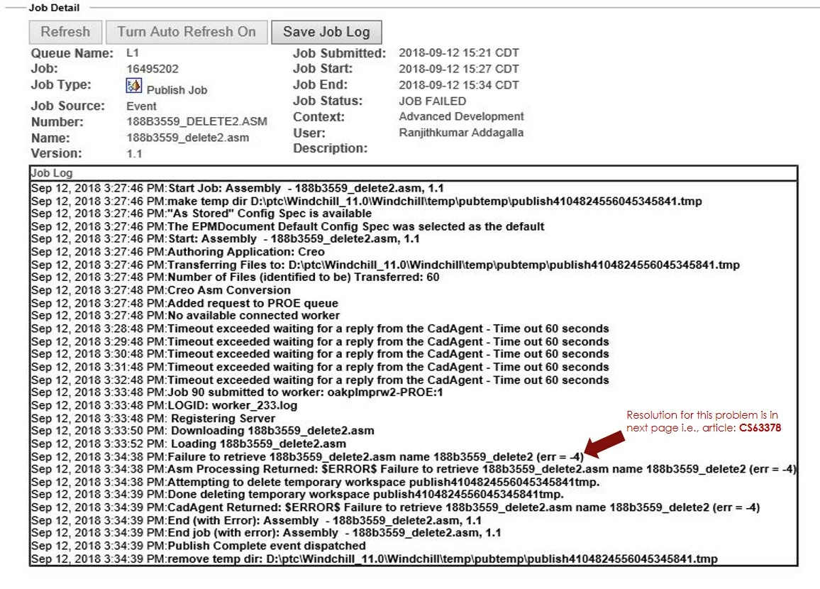

Hello Experts,
I have raised a query previously on publish issue and it is the continuation for that.  Based on the clear observation while publishing, we found out an error as per the figure 1,

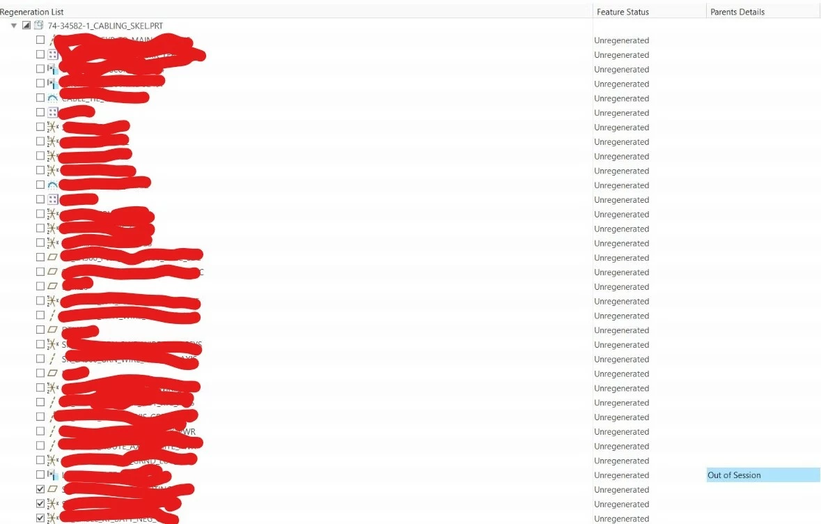

We have traced the error using this article (https://www.ptc.com/en/support/article?n=CS63378&language=en&posno=2&q=Failure%20to%20retrieve%20name&source=searc) and found that the solution will be there in CS139834.  But according to that procedure,  I found the parts are not regenerating and one of the file is not in session.  Please check the figure 2 attached,
 Looking for some solution.  Please do the needful.
Requirements:
1. How to get back the part/skeleton part in to session?
2. How to make the part to regenerate by itself?
I hope based on that, the assemblies will regenerate and publishing activity can be done easily.
