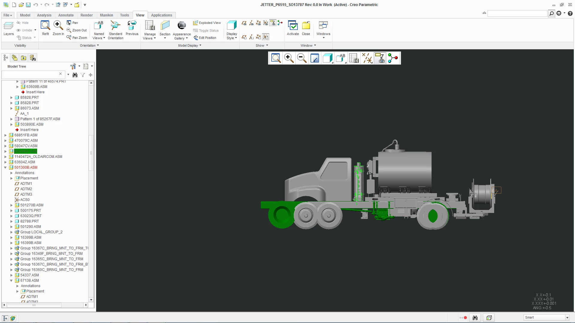

I am wondering if someone can help me with this one. I searched for a part number in the model tree using the search box above the model tree. When the part was located the part number and the associated geometry in the assembly were turned a dark green color. How do I turned this off and put it back like it was before I did this. See the attached screen shot.
Thanks for the help,
Doug
Best answer by ptc-5493477
Deja vu all over again!
this exactly what happened to me!
But I didn't do a search........
hit the incredibly small x in the search window. I must admit, I didn't try this since I hadn't searched.

dwright-21-VisitorAuthor
August 5, 2014
How can something so simple be so difficult. I will put on my dunce hat and give myself a time out in the corner.
Thanks Jim.
August 5, 2014
My pleasure Doug.
Get used to it. Sometimes it's lots worse. You shouldn't be wearing the dunce hat - It's not you, it's them.
