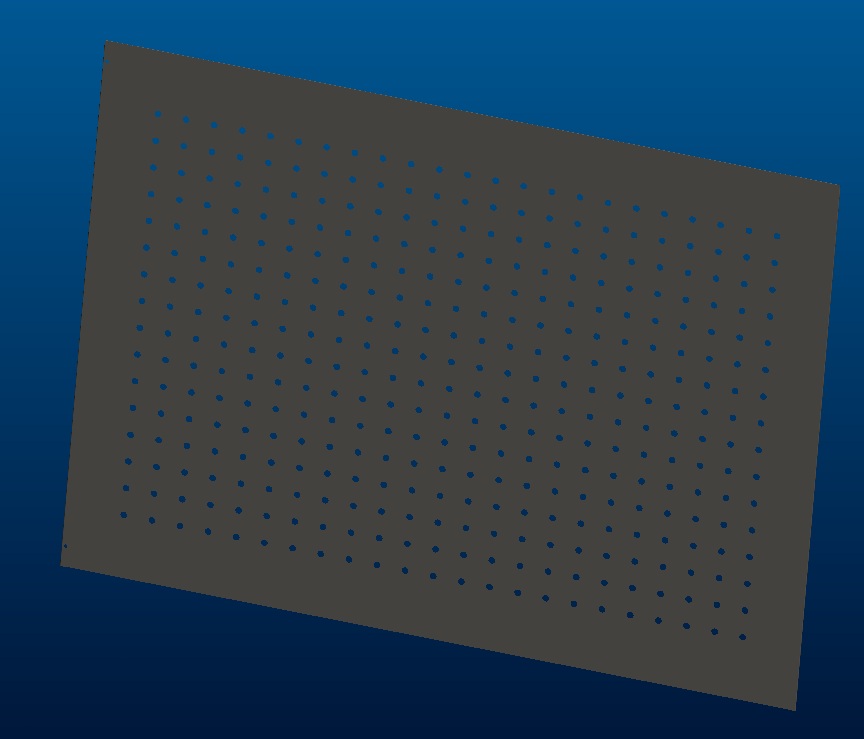

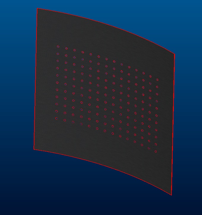

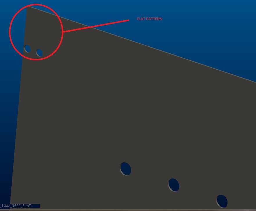

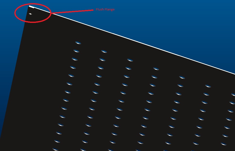

I have a part that has three states.
Flat Pattern
Flush Flange on a Flat.
As installed.
Is there a way to do a partial bend back on just the flanges and leave it in the Flush Flange on a Flat for the drawing? In other words, if created in the as installed state, I can get the flat pattern, but how do I get the flat part with the flush flanges showing?
Thanks, Dale
FYI (Currnetly I have different models and I would like to get this to one model in a table where I can turn on/off flat pattern or bend back features.)

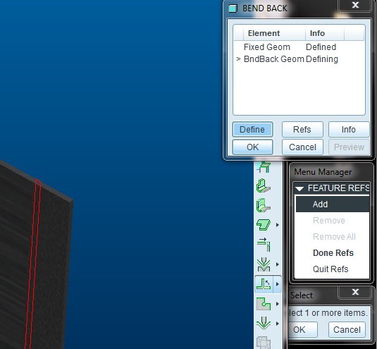

Here is what I ended up doing to get this to work.

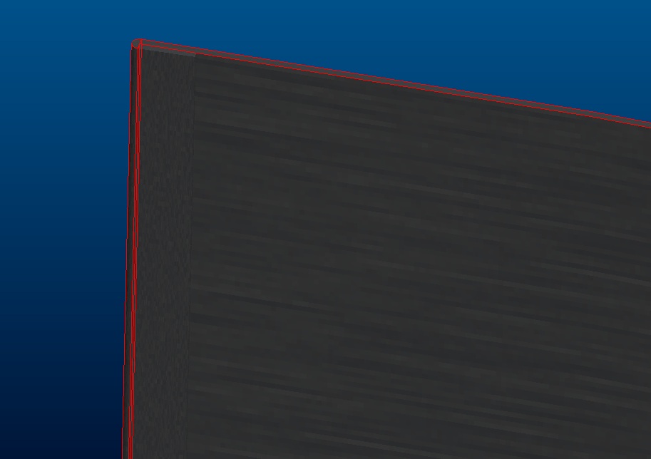

I rolled the part back to before the bend back that made the whole part curved and with both flanges. I then started a bend back. For the fixed geometry, I selected the long edge of the soft curve. I then chose BendBack Sel, then Done. The selected geometery for this was the small portion of material where the flush flange started. Holding the Ctrl and selecting the second flush flange.UNBENT3.jpg
Then select done.
I rolled the tree forward and the complete roll back failed.
I added the two unbends to a family table and for middle model - flat with flanges, Y for the partial unbend and N for the complete unbend. For the curved part, I reversed the two options. For the completed flat pattern, I used the complete unbend and then had a flat pattern.
This worked to get the three states of the model that I needed.
