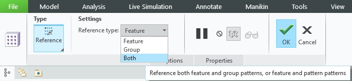

For a Ref pattern of a pattern you need to change the reference type to "both"

@Chris3 likely has provided the solution. Based on the description in the OP it is handled by setting the reference type to both when patterning the component in assembly mode to follow the patterns created in part mode for the component used to drive the placement.

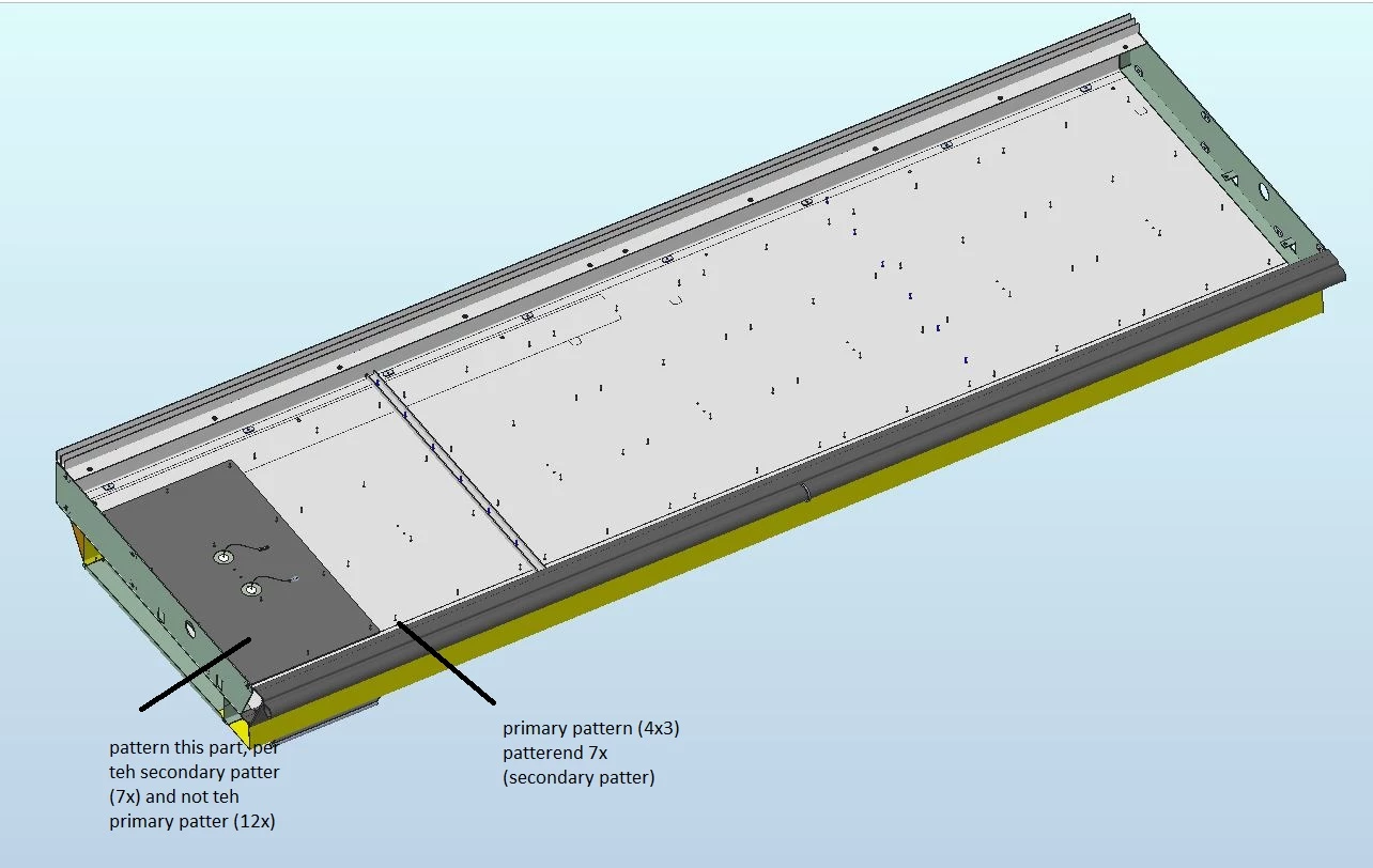

Jan 15, 2024 5:18 PM UTC
Hi guys, thank you for the detailed set of instructions.  But I get that part, as it's easy to apply (to nuts & such..) that makes sense.
What I'm after, is the secondary pattern being the reference I'm after.
@tbraxton  you have a set of 4 holes, which you've patterned 4 times (2x2).  And you've shown how to have a part follow those parts (16 total).  Those 4 holes secure something (say a let or foot in this case..)  The leg/foot has the 2x2 hole pattern.  How do you pattern the leg/foot that is attached to that set of holes?  (make a pattern of 4 legs/feet?)
How do you pattern the leg/foot per that secondary pattern?
see attached.
I have a primary pattern (of PEM studs) patterned 4x3.  I have then made a [secondary] pattern of this pattern (7x1)
I want a set of parts to follow this secondary pattern [7x] across (not follow the 4x3 patter)
I will then add nuts & washers, and those will follow the initial 4x3 pattern, then follow the secondary patter (7x1)
I'm assuming this can be done..  If I can pattern a pattern, I should be able to make a pattern and choose which pattern reference I want it to follow..

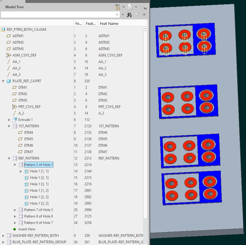

Jan 16, 2024 2:07 AM UTC
Hmm, well, you can try and get a 7x1 pattern of the panel by reference pattern "by group" or "by feature" (depending on the direction).
Here is an example where the red washer is ref-patterned "by both" while the blue plate is ref-patterned "by group":
(note that in the highlighted 2x3 dimensional pattern of holes is patterned "by reference" to the table-pattern of datum planes named 1ST_PATTERN)

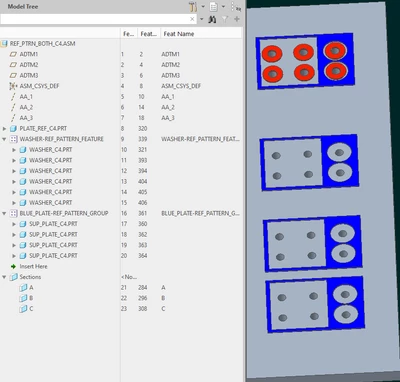

For completeness, here the red washer is ref-patterned "by feature":
