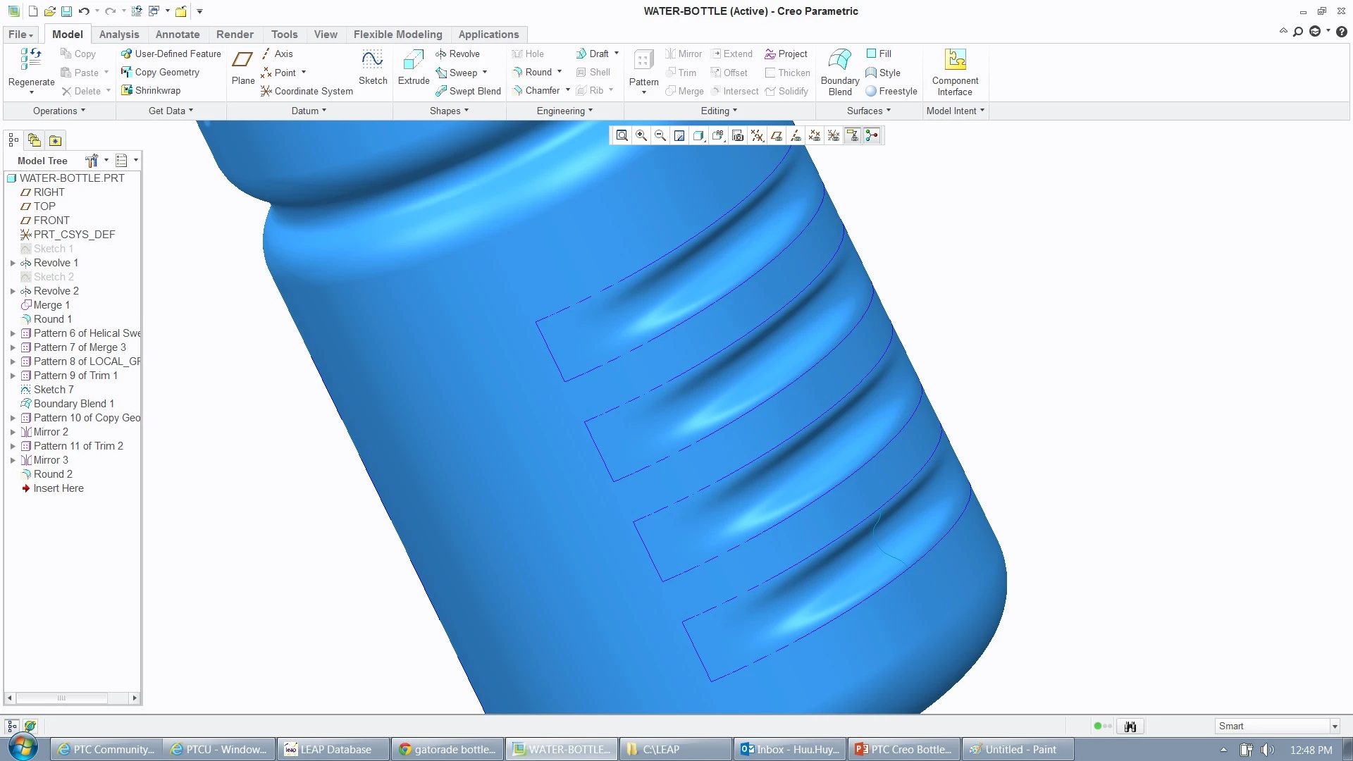

I want to check if it is possible to pattern a boundary blend?
I tried doing this. The pattern would fail, I have to use Geormetry pattern instead.
I have a rectangle cut on a surface. I used boundary blend to blend. I can pattern the sketch, trim, but not boundary blend.
Is there a way to do this?
Best answer by ptc-5498717
Thanks. I got it to work. I created the surface blend once first then create the pattern, then I go back and pattern the sketches, trim and sketch. That sims to fixed it.
I tried to group and pattern first, then create the blend then pattern. That did not seam to work.

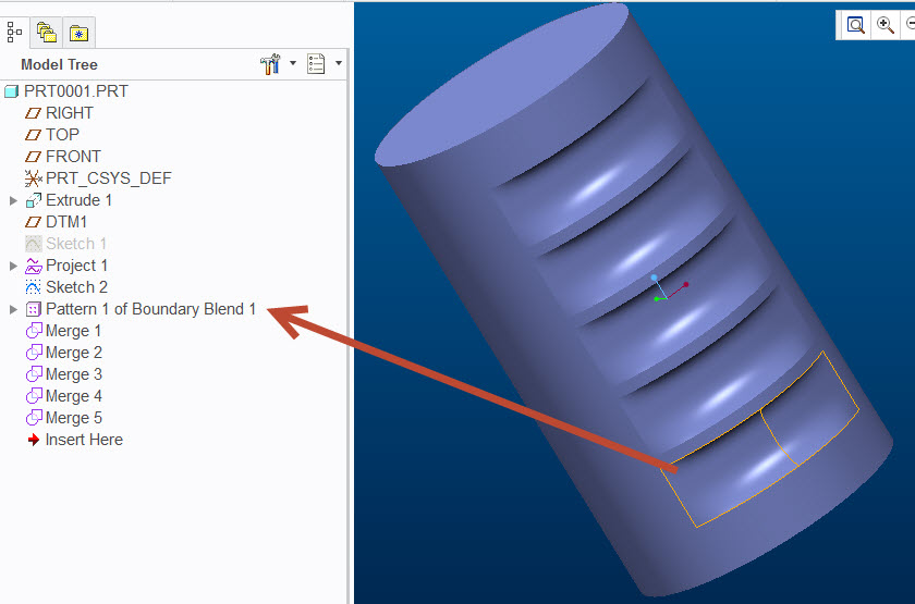

Boundary blend can pattern in a part. Possible reason for failure can be part accuracy, try to change the accuracy of part and check if that helps you.

Patterns can be fussy. Just changing a single reference can make a failed pattern function again.
Patriot_1776
April 2, 2014
I've had instances where on one side of a part I gouped features, then patterend them, and on the other side it didn't work. So I patterened the first feature, then reference patterned the rest and it worked.
Pro/WORKAROUND at it's finest!
My question, is if you're making a bottle (and not just doing a learning demo), why go thru the trouble to make a Boundary Blend for those cuts (I assume, like the video)? You can make a very similar shape without all that baggage by simply making a cut, circular or elliptical if viewed from the top and use a round. You can even get tricky and use a variable radius round. Boundary blends are finnicky at the best of times, best to avoid them as much as you can in the real world.
April 2, 2014
...or just sweep a surface through the bottle quilt, pattern them, and then merge them.
