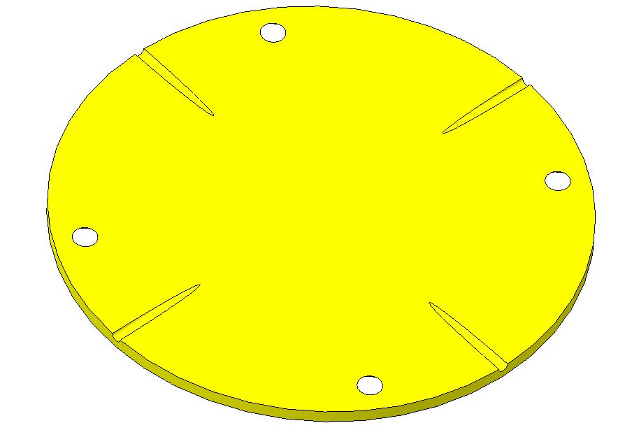

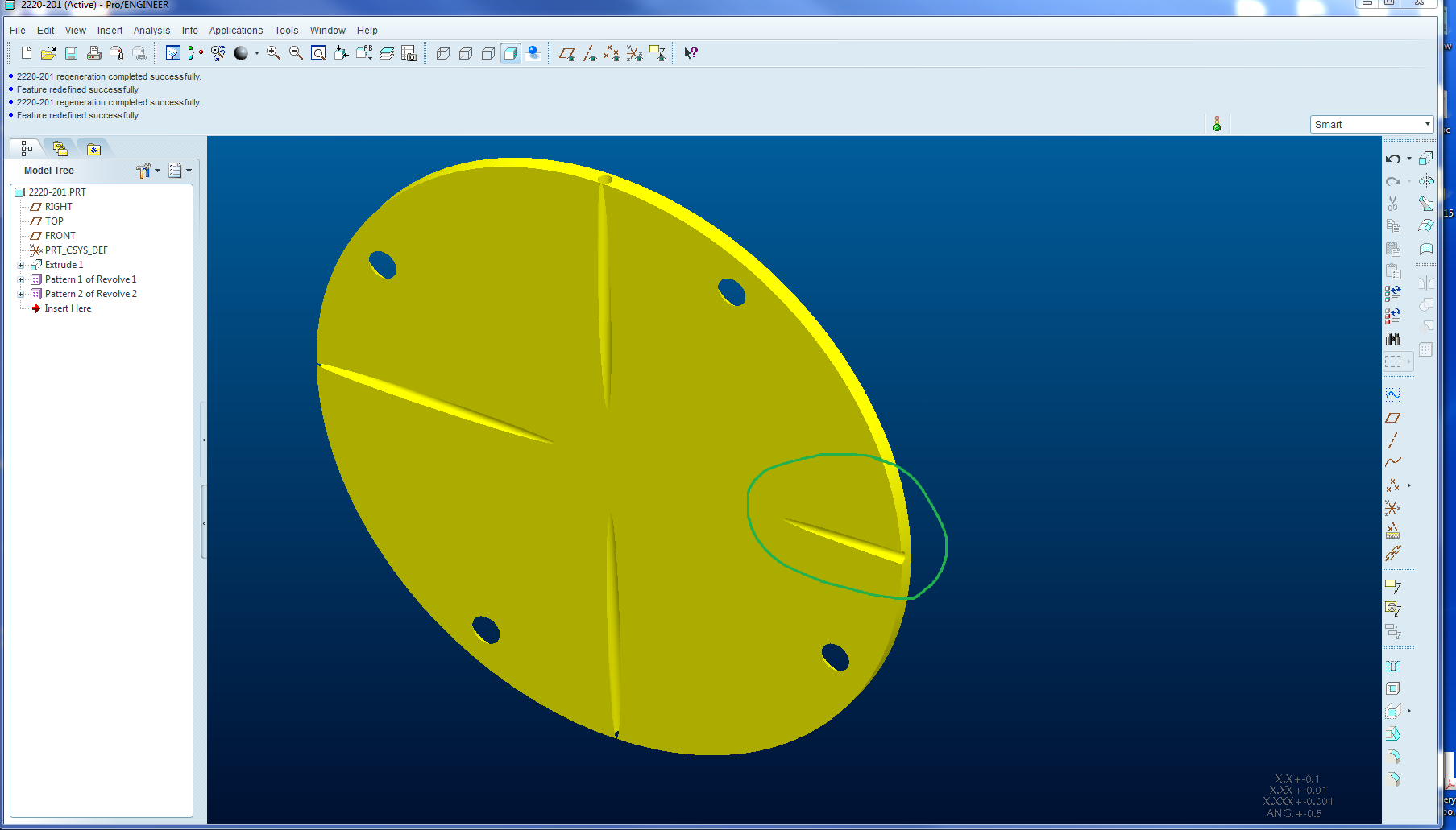

Hi, friends. I created a revolve cut (green). When I tried to pattern it as 4 in 360 degree, different feature shown in rest 3. Need help to fix it. Thanks, Bill

strange. it's OK after pattern recreated .
December 3, 2015
I recreated the problem in Creo 3.0 M060. I deleted the pattern and created again, and the problem persist.

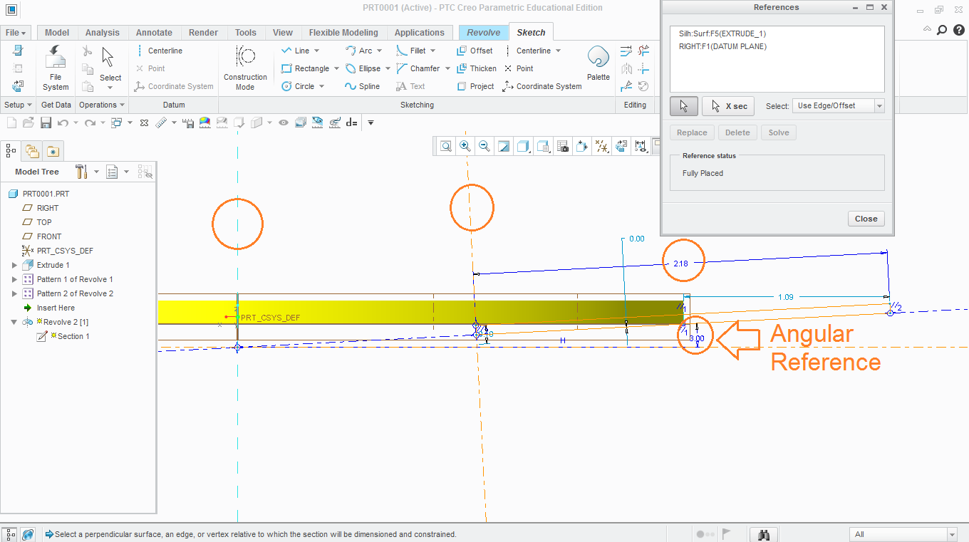

It seems to be a problem in the sketch of the revolve feature. Try to modify the sketch, add some centerlines and add an angular reference, also try to edit the dimension and delete some constraints. It should solve your problem. Your sketch should look something like this.
See the sketch in the file attached, a copy/paste operation should be ok.
