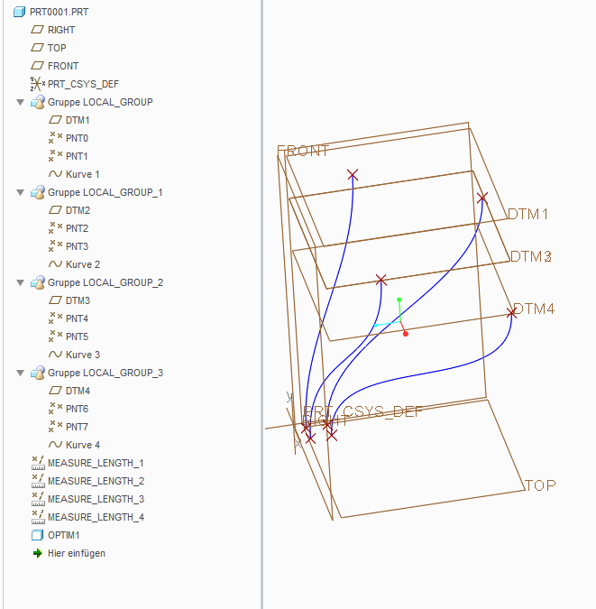

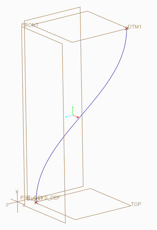

I am looking for a possibility to do the following as a pattern:
  1. 2 parallel planes with one point on each at different plane coordinates.
  2. 1 curve that connects the points with orthogonal condition at the start and the end (with respect to the two planes)
  3. 1 Analysis Feature, that contains the curve length
  4. 1 Feasibility Feature, that varies the distance between the planes, so that the analysis feature (curve length) has a given value
Trying to put that into a UDF, I was told by Creo, that it was not possible to copy a feasibility feature.
I would like to perform the above operations as a 2D dimensioning pattern, where the "lower" points coordinate increments are less than the "higher" point increments. This would result in smaller distance between the two parallel planes.
How can I do that?
I did it manually for 4 curves, but it is not possible to do it for my pattern application manually:
dipi1-VisitorAuthor
July 21, 2015
Is there some possibility at all, to generate the OPTIM1-Feature as a pattern?
