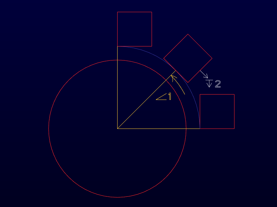

I must be getting tired.
How do I get this pattern to work?
The 1st element is rotation, and the second is a linear translation at the rotated position.
Seems elemental, but I cannot seem to figure out the UI to make this work.
thanks in advance

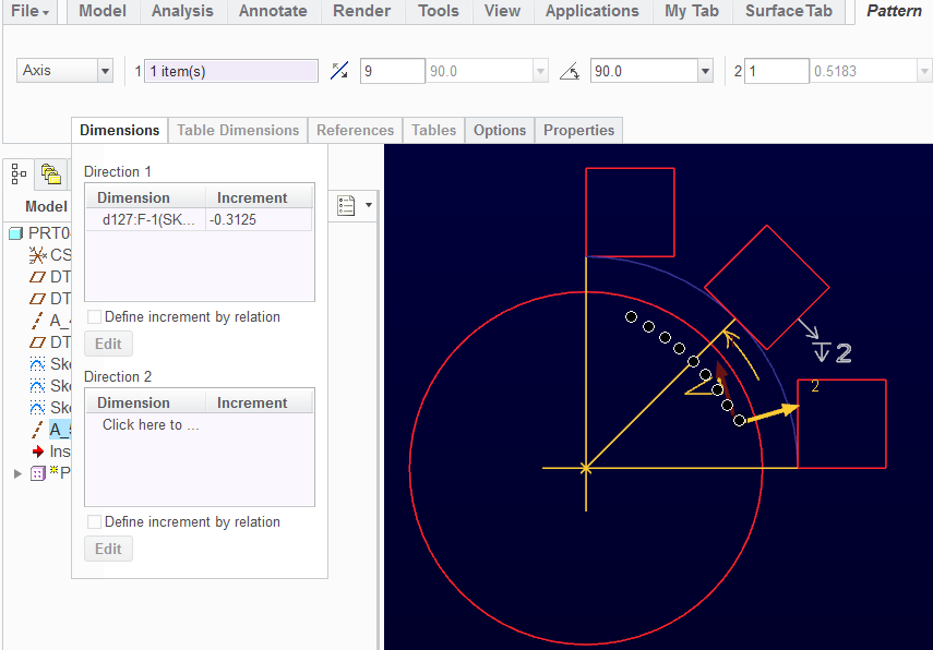

Best answer by TomD.inPDX
I got it to work. Seems relation driven dimensions cannot be used the Direction 1, or certain other types of dimensions. It just ignores the entry rather than providing a warning! Bad form
This is an axial rotation pattern where Direction 1 is d127, which is a vertical dimension from the datum to the long horizontal line. The increment is total:offset*(#:pattern-1)/(#:pattern/2)
17 replies
TomD.inPDX17-PeridotAuthorAnswer
July 14, 2014

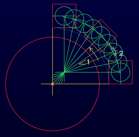

Matt, this is only a simplistic model of what I am trying to do. In the mnore complex version, I am running into all kinds of limitations including wrong origins and not being able to correct for them and models not tilting or not rotating. Really frustrating!
I am trying to mimic this interpolation of a gear hob. This requires moving the pattern across the surface of the pitch diameter while tilting it.
http://i1.ytimg.com/vi/t7uvkRgkL8M/hqdefault.jpg
