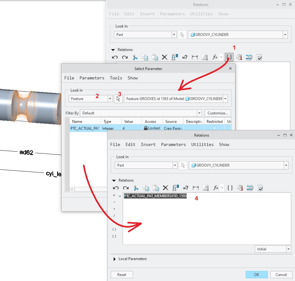

Basically I am making grooves for a tiny coil of diameter like 0,5mm on a small cylinder body. I have made my 'groove', and revolved it around the axis of the cylinder and then patterned it using fixed spacing (pitch).
But I have to manually adjust the length of the cylinder body sketch to make sure it doesn't get interrupted.

PTC_ACTUAL_PAT_MEMBERS is a feature level parameter that belongs to a specific pattern.  To insert it into other relations use the [] button in the relations editor, and then look for it by pointing out the pattern feature:

You can control it through relations.  Create measurement before groove, create pattern, then create relations.
YY = (DISTANCE:FID_MEASURE_DISTANCE_1-d5-d4/2)/D14
Y = CEIL(YY)
P15 = Y
Where DISTANCE:FID_MEASURE_DISTANCE_1 is a saved measurement of the cylinder (you could also use the length value of the extrusion), d5 is the offset to first groove, d4 is width of groove d14 is pattern spacing an P15 is number of instances.  A manual regeneration is required to update it when a change is made.
