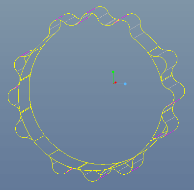

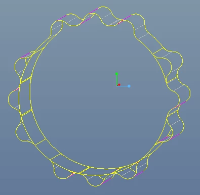

As I hope the picture shows, I'm trying to create four groups of three bosses. I'm working in surfaces, merging each boss extrude to the 'base' cylindrical surface, and eventually I'll cut the whole surface from my solid, to replicate the milling operation.
The obvious approach seemed to be to create one group of three as a table pattern, then pattern that pattern for the other groups. So far, so good - but having reference patterned the merge across the first group (normally I love ref patterns), there is no option to pattern the first reference pattern of the merge.
You can see that I've applied a separate merge to the leader of the second instance of the second pattern (still with me?!?), but when I try to ref pattern that, one of the patterned merges fails. The same thing happens if I create the first three extrudes as copies, then pattern each one (4x) individually - when I create the second pattern of merges, they fail.
Any pointers? Ultimately I could just table pattern all 12 in one go, but that doesn't quite capture my design intent...
I'm using WF4 (with pre-Wildfire colours, because yellow side and red side are easier to understand than brown side and different shade of brown side...)
Thanks!

If I pick the boss as the primary quilt and the cylinder as the secondary, the merge will not pattern at all. The second merge fails. The ref pattern works fine for one level of pattern - it's only when I try to pattern the pattern, or merge a second group of bosses, that it fails.

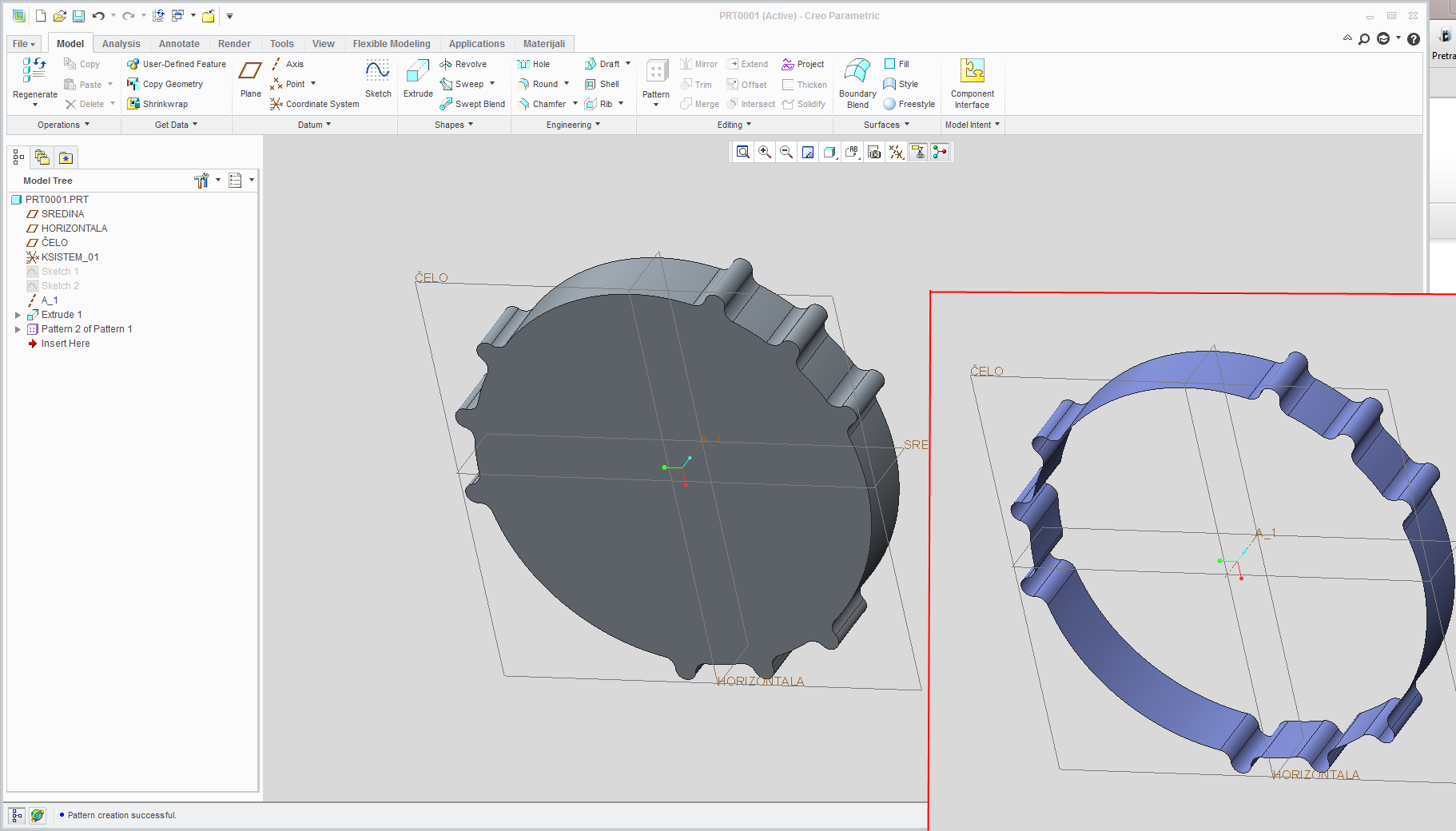

How about you make solid part with all the patterns and then just remove the front and back surface and basicly get what you wanted in the first place.

Hmm... I specifically want this as a surface so that I can cut it from a solid that's slightly more complex than just a cylinder.
I'd have to create this solid right at the start of the tree, then copy the surface I want, then presumably cut the solid away...
July 4, 2012
Just use remove feature and select front and back surface and check "leave open" option. Not sure how that feature looks in WF4.
If solid part that you are milling this from is more complex or you cant do this in that part just make this in some other then publish/copy geometry from that part to the part you are milling it from.
