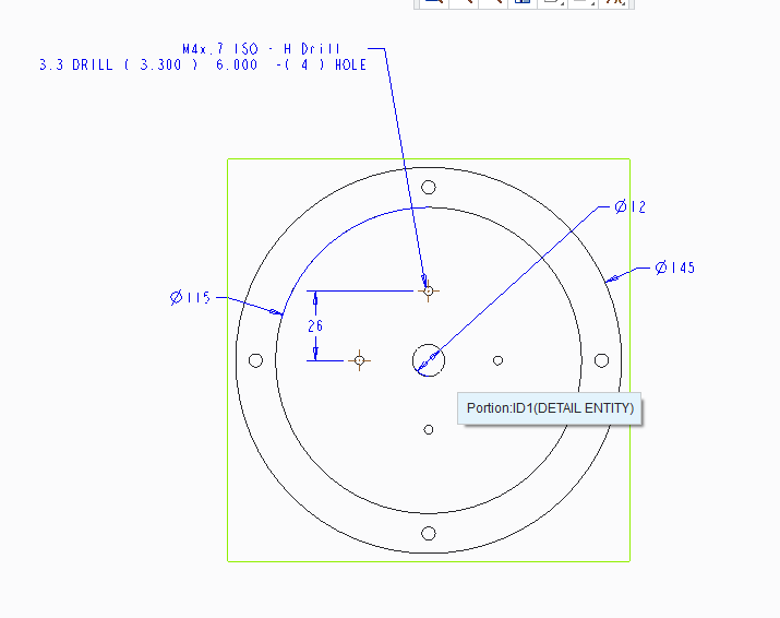

Does anyone know how to make the PCD reference line in detail drawing?
Here is the example of my drawing. I want to do the proper way instead of doing the 26mm dimension.
Thanks.

Set this in your drawing detail config option (not config.pro):
radial_pattern_axis_circle YES
If the holes were patterned on an axis and created as diameter reference in the model, you should get the BCD centerline.
Please share your file if you are still having trouble with this. It could be how you are modeling the holes if this does not work.

I am trying to do the same thing as Muhamed, in Creo 3. I cant find the option. Can anyone help?
Or is there an easier way to do this? I don't understand why there isn't an option to add a circular centre line on the drawing.

As Antonius  answered, you can get the bolt circle centerline if you use a pattern and you have preset the drawing setup option radial_pattern_axis_circle YES.
In the past when making that bolt circle axis, if I couldn't add that option for some reason, I've add a sketch to the model so as to be able to show it.
