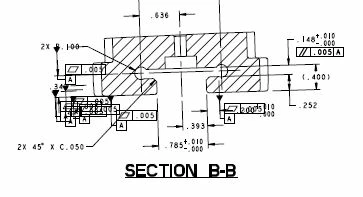

Below is an screen shot of a section view. This is taken from just one sheet of 10 with basically the same part in other variations. The Datums were created and set in the model file and shown in the drawing. When looking at the drawings in Creo all looks good the Datum's are in their respected places on each sheet. Some of the sheets do not have GD&T done on them as they are not being used. When saving, printing, and even exporting to create a PDF all the Datum's show up on all the sheets such as seen below. The Datum's were created in the model and than to be shown in the drawing. The flatness info was added in the drawing and attached to the Datum. The Parallelism callout does not have the same issue as the Datum it was created and attached to the dimension on the drawing only. I have tried printing the drawing straight from Creo and still get the same issue. It does not matter if I save the drawing just as one sheet or all 10 all the datum's.
Any helpful and informative feedback would be appreciated, Thank you.

Best answer by StephenW
If the drawing was saved from an older file, it's possible this may be the solution.
Ignore the config.sup options.
Primary one to try is the drawing setup file option:
(Once you apply the option, if it fixes the specific issue, you'll also need to review the entire drawing to make sure nothing unexpected has changed)
Detail Options:
  1. File
  2. Prepare
  3. Drawing Properties
  4. Detail Options
    • Update_drawing all (applies all updates. Use caution as this command may make more changes than are desired)

What release and date code of creo are you running?
I've never seen the issue with GD&T but I have seen callout circles "bleed thru" sheets. I think it was creo 2 an early build and the solution was to move to a later build code.
There are also some drawing update functionalities you can use if you are working on a drawing that is from an older creo release.

I currently have Creo 3.0 installed on my computer some my fellow coworkers and even boss have tried to create PDF of the file on their computers using the same version of Creo with the same results.

Is it a drawing done some time back in an older version of Creo, if so, you may want to try the drawing update functionality.
Look at https://community.ptc.com/t5/Creo-Blog/Fast-Facts-Quick-Tips-for-Using-PTC-Creo-Drawings-Part-3/ba-p/443939?art_lang=en&posno=7&q=update_drawing%20all%20applied&source=search to see if possibly you may be able to us that.
