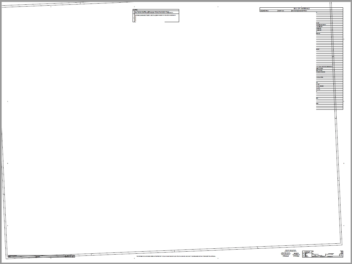

Hey all,
I have recently been upgraded to Creo 4.0 M080 and I have started having an issue whereby exporting drawings to .pdf results in a drawing border rotated relative to the page. See attached image.
Does anyone have a solution for this? I have tried all of the different settings on the export screen. FYI, I create the .pdf using File>Save As>Export.
Thank you.

That's pretty extreme. Is this on every drawing or just this one?

I tried a completely unrelated BOM drawing and the export worked perfectly. So the question has changed slightly to what could have changed within a drawing to make this happen when you come to export. The drawing displays correctly in Creo.

I've never seen it do any like that before. Maybe a just glitch.
I would probably try to get away from that drawing if at all possible.

Hey all,
Just to close this out, I know it's not a real solution but I ended up recreating the drawing. I tried all of the suggested solutions and a few of my own and nothing worked.
This was a BOM drawing, not particularly complicated as the explode and views were saved in the model, just a lot of placing balloons. Anyway, with the old file renamed and the new file saved, everything exports as it should. Thanks for the help.
