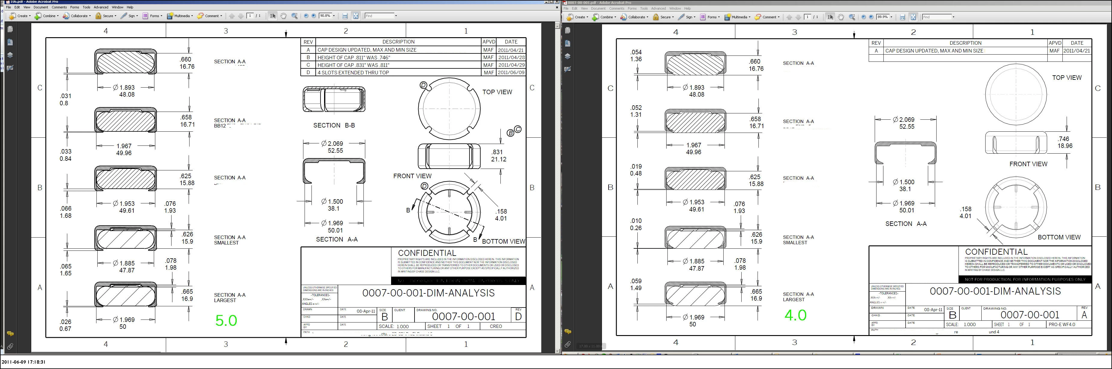

On the question of PDFs.... if I make a PDF of a drawing in WF4.0, then open the same drw and export it in WF5.0 the PDFs look different. Yes, same settings.

I didn't do anything. I'm guessing that just sets the PDF output settings to "stroke all fonts" as default. We need to use true type fonts for our title block and besides the PDF output has changed in the line appearances, not the fonts. I tried all your other possibilities for config options but nothing else came up.
Here is a screen capture of a drawing (confidential info blanked out). The right side was outputted from 4.0 into PDF and the left was outputted from 5.0 into PDFD using the exact same settings.

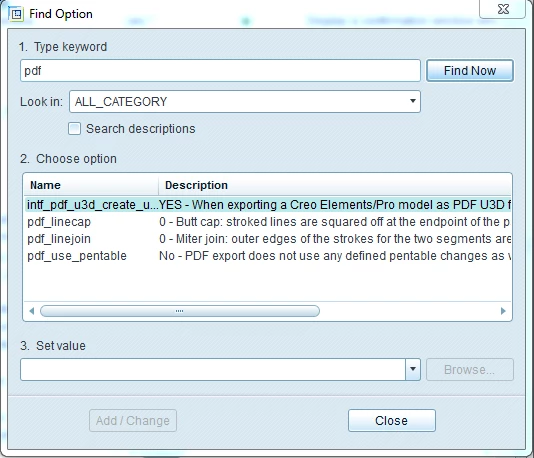

Greg,
I you use the "Find..." button on the Options dialog, and input the items I mentioned before you will find all the other options available (See image). Based on your sample it looks like a pen table issue too. See pdf_use_pentable.
Also if you search for "ttf" you will find ttf_handling_for_plot_files. I don't know if this will help as I have not used it in the past but looks like it might be worth trying.
David.
