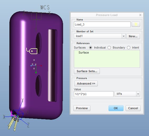

I've tried what is suggested in this two papers:
  1. http://www.google.ch/url?sa=t&rct=j&q=&esrc=s&source=web&cd=4&cad=rja&uact=8&ved=0CDMQFjAD&url=http%3A%2F%2Fpfproe.pl%2F…
  2. http://support.ptc.com/cs/fr_21/howto/mst2742/mst2742_f.htm?_ga=1.255711937.857534450.1425991567
but I don't understand why, in each of them, the point of impact is not where we have the maximum stress.
Rather, it seems that there is no stress (Von Mises) near the area of imposition of the load.
Furthermore in the PTC examples you set the load as a pressure of 1 MPa; ok but nobody talk about the area. This is because you let the load change by the function specified in the Dynamic Time Analysis: this function is obtained from a previous analysis, e.g. in Mechanism, as a force curve (Newton) in function of time. Using the 3D Contact in mechanism, you can estimate also the variation of contact area.
So in Mechanica/Simulate you impose the force curve on an area that you can take as the max or the average of the value of the Motion/3Dcontact measure.
But the load is a pressure, not a force, so in my opinin you have to impose a pressure of 1 [MPa]/Area [mm^2] and let vary this load by the function.
In this manner you impose the real force of the curve.
What do you think?

Jul 28, 2022 12:17 AM UTC
If you need a high fidelity simulation of an impact or collision event you need a nonlinear capable sim code. I do not think Creo simulate is the best option for this. You will need to be able to deal with contact elements that separate and come back together as one example where I think Creo is lacking. I could be wrong if they added functionality but the last time I looked at the tool it could not support these things.
ABAQUS is the solver used in most of the designs I have worked on that had impact simulation done on them. It is $$$$$ and you need someone skilled in the use of it in order to get an ROI.
