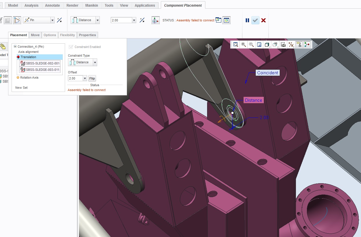

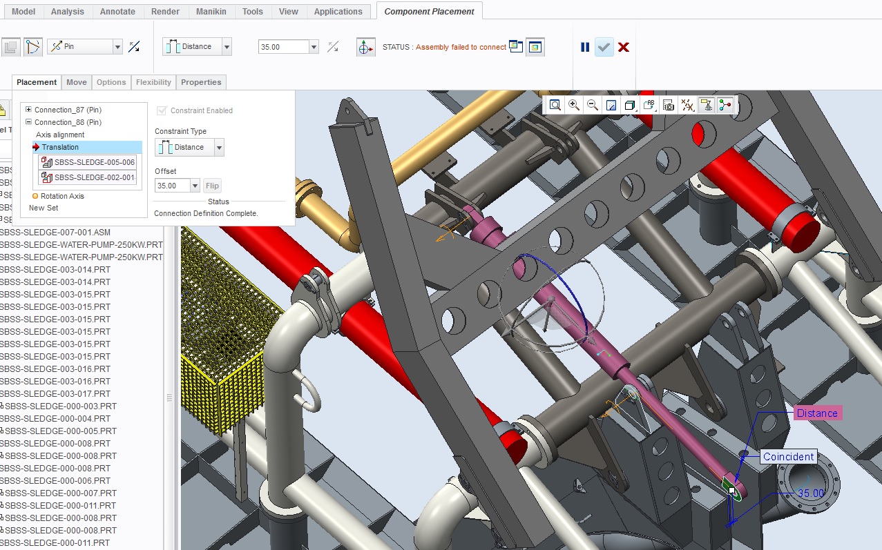

Hi Guys,
I need some help. Initially all was right and ok. After i changed the parts (hydraulic cylinder), i can't even do the pin assembly. Note that my pin assembly has 2 sets as my part is a hydraulic cylinder.
To let you know, the changes on the hydraulic cylinder is only the bore diameter.

even a simple pin connection also fail now.

are you able to reproduce the problem on simple testing assembly ?

no luck.  but tomorrow we gonna check the subassembly connection. maybe got connection errors.

So i answer my own question.
We found that there is a problem with the sub assembly.
What we did is we suppress all sub parts and resume one by one, at the same time try to do the pin assembly after one another.
There was a problem with the tangent assembly on one of the parts.
