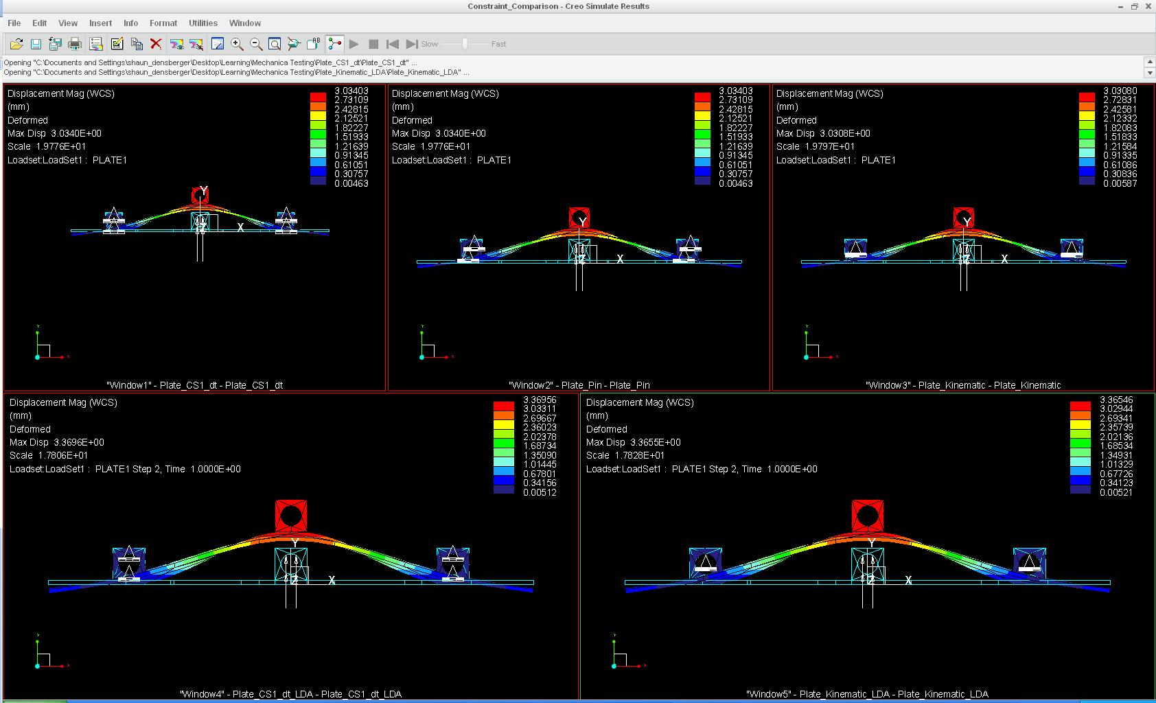

I went through your model and it looks like you're both constrain methods you previously tried did allow rotation (it's just a very small amount of rotation). I ran three different constraint methods: (1) pin constraint, (2) cylindrical coordinate system with theta free, and (3) a kinematic constraint with Rzz free. I also ran the methods (2) and (3) as a large displacement analysis (note that you can't run a LDA with a pin constraint and that I changed the load from a bearing load to a standard load as bearing loads aren't allowed for LDA); a screen show of displacement results for all 5 runs is shown below.

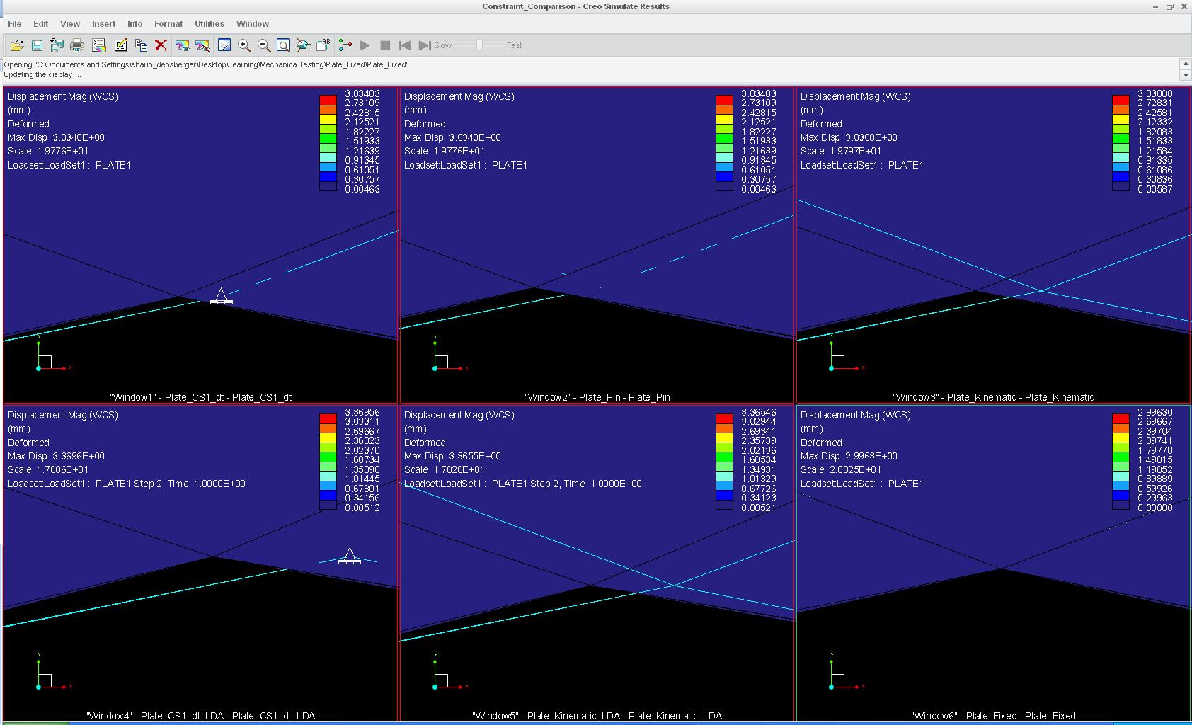

You'll notice that all methods have essentially identical results (the kinematic is a little smaller because the rigid link adds some stiffness to the model), and that the LDA models give above 10% higher displacements. Taking a closer look where the constraints were applied, we can clearly see that rotation is occurring (I zoomed into the top inside hole surface corner of the left lug). You can clearly see that node moves from it's original location for all methods except for the fixed.
To provide a little more clarification, I run method (2) and a fixed constraint with a moment measure on the constraint surface. For method (2), a moment of -3.157766e-08 Nmm was calculated, but for the fixed constraint a moment of -1.533312e+05 Nmm was calculated.
Now, at the end of the day, I think you and I are on the same page that the deformed shape doesn't "look right", as we'd expect to see larger rotations at the pin joint. I think part of the reason we're not seeing larger rotations is that the lugs effect the local bending stiffness of the plate, resulting in a change in the curvature of the bending.
