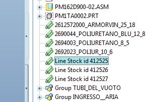

Hi all,
do you know the logic ProE uses to name the Line Stock inside the model tree?
I get the informations for the line stock from external files but I am not able to force the program to adopt a specific name for the model tree.
The names are always "Line stock id ...." and a progressive number. Every times I have to rename each line stock.

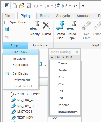

    What version of Creo are you using? From the icons, it looks like a slightly older version... but I did some testing for you in Creo 3.
    If you are using "Spec-Driven Piping", Creo will automatically name the linestock features for you - as "<SPEC-NAME>_<SIZE>_<SCHEDULE>"
    If you are using "Non-Spec-Driven Piping" ... one thing you can do is "Write" out the linestock feature (which, it sounds like you have already done). If you rename the text file it to have the desired name you want, then from now on, you could easily just "read" that file in for every new model, and not have to rename the linestock. Whats strange is... it sounds like that is the process you are already using... so maybe it has been fixed in Creo 3?
    • If you look at the picture below, I actually have two new linestocks for "LNSTK001" and "TEST_NEW", which were both read back in to Creo from the files I created using the "Write" command
    Hope this helps,

    I use "Non-Spec-Driven Piping" with Wildfire 5.
    I already have a lot of files stored in a folder but if the name of the file is "pipe_n5.stk" happen that the name of the line stock that I read inside the list is correct, but the name inside the model tree is, indeed, "Line stock id ....".
    the only manner that I see to obtain the same name is to write the pipe within the Setup->Line Stock menu.
    So if I have my own library of pipes, I need to rename them in the model tree everytime.
