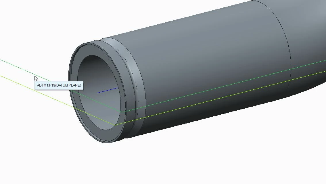

Is it posible to create a start_part for piping with code [program or relations] to create a datum_plane at spool first and last length?
What I am trying to achieve is to do a end treatment of the pipe fast and easy.
See attache picture.
Program Creo 2.0 Parametric with piping extention.

Thanks for the answer.
I am using UDF wiht a family table for all dimensions, to create the features.
But the UDF requires a Datum_plane to place the "revolve sketch".
What I am trying to achieve is to automate the process through a script or simmilar in the start_part.prt
Does this make any sense at all ?
